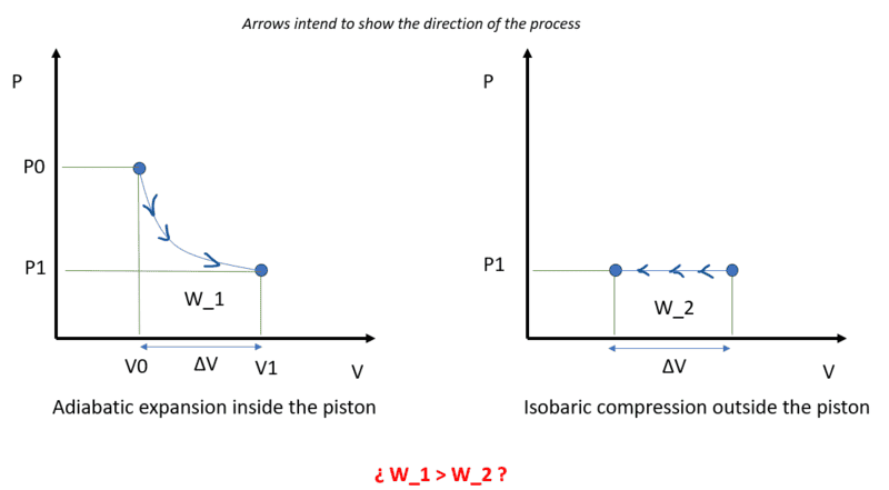

The way I see it, the work done by the adiabatic expansion of the gas inside the piston must be equal to the work done in the isobaric compression of the gas outside the piston because energy has no other place to go since heat transfer is not allowed (adiabatic system) and any other path for energy has been restricted (frictionless, massless, etc.).
The gas inside the piston will expand until its pressure levels with the outside pressure (P0→P1).
The energy required for such expansion would come from the internal energy of the gas inside the piston which can be expressed as a function of temperature (ideal gas).
However, I don't see how those two Works (adiabatic expansion in the piston and isobaric expansion outside) can be the same.
I'd need to include something else. For example, if the piston had mass, the difference in Works would be absorbed as kinetic energy of the piston and would be ##K_p = W_1-W_2##. In that case, the piston would reach the equilibrium point with non-zero velocity so it would overshoot and an oscillating movement would start. With friction being removed from the problem as the statement declares, the oscillation would keep going indefinitely.
This differs a lot when compared with what was done in the original thread. For example, Vanhees71 used the thermal energy in the gas to match the isobaric compression of the outside gas but I don't understand why it's possible to do that if it's been established that the piston undergoes an adiabatic expansion.

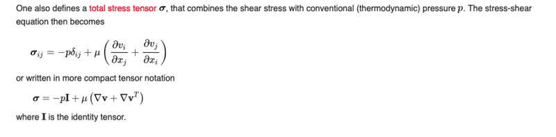

Are you familiar with Newton's law of viscosity in 3D, involving the stress tensor and the velocity gradient tensor? (Wiki)
I didn't see the viscosity of the gas as a possibility in this problem although I now realize that might have been the main point from the beginning. I haven't worked so closely with fluids in quite a while but I understand the losses due to viscosity are related to the different velocities in it and the shear that appears between "layers". I hope a conceptual understanding of that is enough to understand the expansion being discussed here.
So, in an ideal case, the expansion would have been adiabatic and would have produced ##W_1##. However, the produced work will be lower because there are losses due to the viscosity of the fluid. The difference in area between the ideal path and the actual path would be the losses due to the friction in the fluid. Such losses will produce heat but it cannot escape the system because it's adiabatic. What will happen to that heat then? Will it be stored as thermal energy in the gas? Can we even call it losses if it's not being lost anywhere?
Also, work produced during the expansion depends on the PV curve of the gas inside the piston. How can we then know what's the PV curve that the gas follows during 0→1? Does it even make sense to plot such a curve if the gas no longer follows PV=mRT because of the rapid expansion?

It isn't exactly a vacuum. Viscous stresses (which can be negative) reduces the normal stress on the piston. The normal stress depends not only on the volume, but also on the rate of change of volume.
Even for a gas undergoing shear between layers, the deformation can be resolved into pure extension at+ 45 degrees to the layers, and pure compression at -45 degrees to the layers. So viscosity doesn't only come into play with shear between layers, but, more generally, with extension (like normal to the piston face). This causes a negative contribution to the compressive force on the piston if it is moving fast enough.
There is less work done by the gas on the piston (because the normal force is less than in irreversible) and less change in internal energy.
Super question. Of course, if the piston is massless and frictionless, then the work done by the gas is equal to the imposed external pressure integrated over the volume change (since the gas normal force must equal the imposed external pressure times the piston area). If the external pressure is not known (i.e., specifically imposed as a function of volume), then we need to solve the detailed partial differential equation of fluid mechanics and partial differential equation of thermal energy in conjunction with the continuity equation (differential equation of mass balance), subject to the Imposed boundary conditions for velocity and heat flux at the cylinder and piston surfaces. This requires the use of computational fluid dynamics.

Pressure is the isotropic part of the compressive stress tensor. This is not the force per unit area exerted by the gas on the inside face of the piston during an irreversible deformation. The compressive stress exerted by the gas on the inside face of the piston is: $$\sigma=p-\tau$$where ##\tau## is the viscous contribution to the compressive stress. See Transport Phenomena by Bird, Stewart, and Lightfoot, Chapter 1, Section 1.2

at the inner face of the piston. The pressure on the inner face is the same as the pressure on the outer face.
Again, the compressive stress on the inner face is the same as the pressure on the outer face.

Juanda said:
I have an ideal gas in a cylinder with a massless, frictionless piston, and the gas starts out at To, Po, Vo. The system is adiabatic. The gas is in equilibrium at Po because the piston is held in place by a braking system. I initiate an irreversible process by releasing the brakes so the piston is exposed to the lower external pressure P1 which is constant while the gas expands and equilibrates with the new external pressure P1 at a new volume and temperate V1 and T1.
(a) Based on the 1st law of thermodynamics and the ideal gas law, what are the values of the new volume and temperature (in terms of Po, To, Vo, and P1)? How much irreversible work was done? What was the change in U
All that matters are the initial and final equilibrium states of the gas inside the piston. To determine the final state you just need to know how much energy was extracted during the process and that just depends on the amount of work done.
The difficulty in real life would be in determining the work done because the gas in the piston would be applying a force not only to overcome opposing pressure and friction on the piston but also to accelerate the piston. That is why the problem is simplified by making the piston massless and frictionless and making the opposing pressure, P1, constant.
So, with the given facts, the work done by the gas inside the cylinder in this irreversible expansion is simply P1ΔV=P1(V1-V0). Applying the first law (Q=0 as it is adiabatic): ΔU=-W=-P1(V1-V0)=nCVΔT
