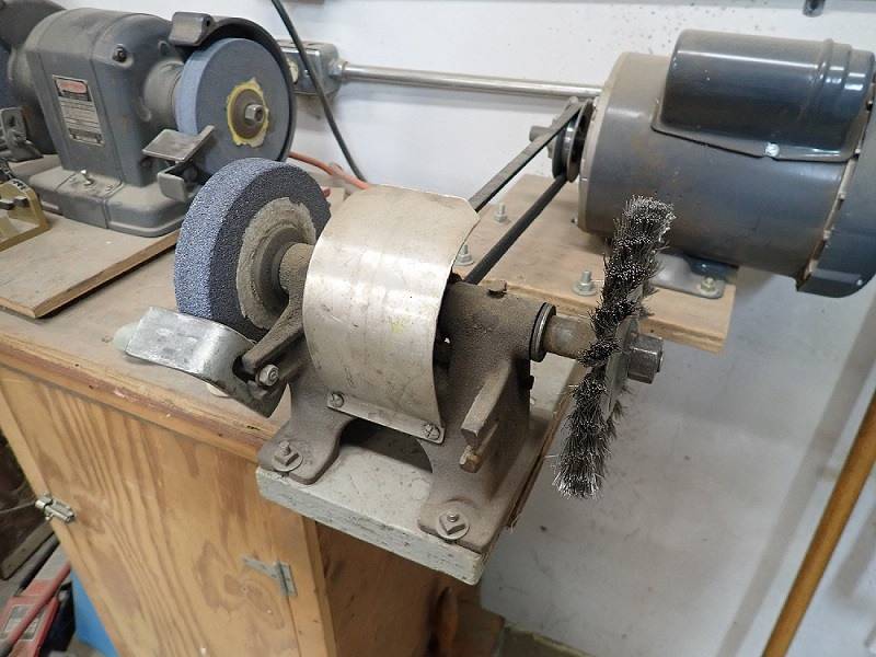

While there are published recommendations for journal bearing clearance, viscosity, and alloy, you will not find anything applicable to your situation because this is a high speed, high load application. Your best source is the reducer manufacturer. If that information is not available, and because of the high speed and load, a detailed bearing analysis is needed. An analysis of the detail necessary is beyond what we at PF can do for you.
If you really want to work on this problem, get a book on machine design. It will have a chapter on journal bearings. Study that first. Then, if you still want to work on it, and because this is a high speed high performance application, get a copy of Fundamental of Fluid Film Lubrication by Bernard J. Hamrock and study that. Since you have a master's degree, this is within your abilities.
And no, there are no shortcuts. Not for these loads and speeds. If you were designing babbit bearings for a 2000 RPM 1/2 hp grinder like the one in the foreground below, there would be shortcuts. But not for your speeds and loads.
