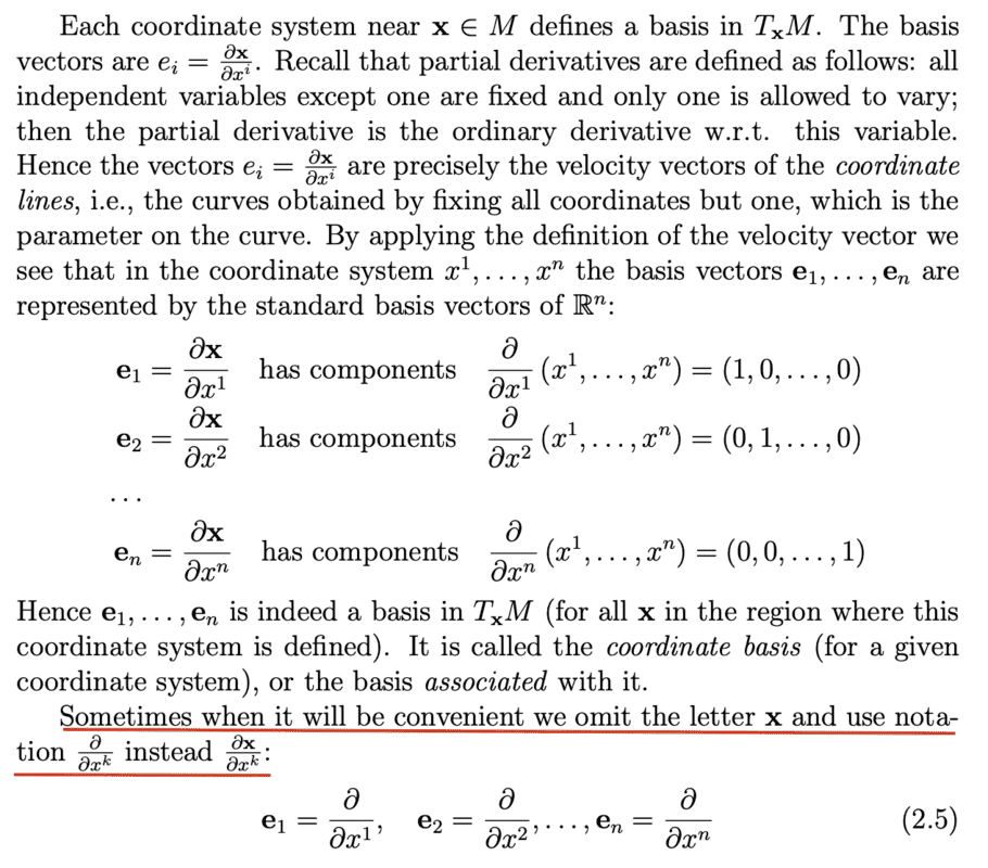

I was reading these notes and then on page 23 I saw something a bit weird. Back in this thread I learned that ##\{ \partial_i \}## form a basis of ##T_p M##, and that a tangent vector can be written ##X = X^i \partial_i##, and it's not too difficult to show that components transform like ##\bar{X}^j = \frac{\partial \bar{x}^j}{\partial x^i} X^i##. But this guy says that
The most alarming part of that is that he seems to suggest that ##\frac{\partial}{\partial x^i}## is just shorthand/notation for ##\frac{\partial \vec{x}}{\partial x^i}##. That seems quite wrong, since I thought the operators ##\frac{\partial}{\partial x^i}## are basis vectors already, in their own right. And ##\partial_i## and ##\partial_i \vec{x}## are completely different objects. Plus, the base space is not even necessarily a vector space, in which case I thought the position vector ##\vec{x}## is not even defined!
So I wondered if this section is wrong, or if I am missing something 😁. Thanks!

I think that ##\vec x = (x^1, x^2, \dots , x^n)## is slightly loose notation, as this is more the coordinates than a vector. But, I'd say ##\frac{\partial}{\partial x^1}## is definitely shorthand for fixing all other coordinates and letting only ##x^1## vary.
The transition to treating ##\frac{\partial}{\partial x^1}## as a vector, however you define it, is by identifying a basis vector with this and then the key ingredient is to define an inner product by making the inner product of your basis vectors dependent on the metric.
Effectively what you have done - when all is said and done - is simply defined a tangent space with an appropriate inner product. How precisely you relate that back to the manifold is not actually that important.
PS I mean the precise justification is not important. You obviously have to get precisely the right inner product on your tangent space.

They are if you use the one-to-one correspondence between vectors and directional derivative operators, and treat ##\frac{\partial}{\partial x^i}## as the directional derivative operator along the "coordinate grid" curve on which only ##x^i## changes and all other coordinates are constant. I think that's what this author is referring to when he says that ##\frac{\partial}{\partial x^i}## are "the velocity vectors of the coordinate lines". I agree he is fudging somewhat when he appears to treat the n-tuple of coordinates as a vector.
Ah, okay, I think I get it. He's writing coordinate basis of ##T_p \mathbb{R}^n##. I think I was getting confused because in a Euclidean space, where a position vector makes sense, sometimes it's written$$\vec{E}_a = \frac{\partial \vec{x}}{\partial y^a} = \frac{\partial x^i}{\partial y^a} \vec{e}_i$$where the ##\vec{e}_i## are a Cartesian set. But that's a different usage of the symbol ##\vec{x}## to what he's doing here. Thanks!
