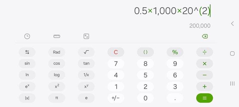

@pete94857 I’d like to add to what @jbriggs444 has said,. You might want to try this…
A car has mass 1000kg (not ‘weight 1000kg’ by the way, because in physics 'weight' is a gravitational force measured in newtons!).
The car accelerates uniformly from rest and covers a distance of 100m in 10s.
a) What is the car’s initial speed?
b) What is the car’s average speed?
c) What is the car’s final speed?
d) What is the car’s final kinetic energy?
Your original problem isn’t that different from the above if you think about it. You are just using angles rather than distances and moment of inertia rather than mass.

I'm trying to do this problem first thank you.

I apologise for missing bits out ref should be pi radians/ time. I'm finding it difficult to see why the angular velocity is not equal to the final velocity.
You should find your Post #1 problem easier once you can do the (simpler) Post #37 problem!

Yes I do yet it I just had a very bad migraine yesterday but didn't want to be ignorant to your efforts I do really appreciate it thank you
No problem. Thank you. I hope the migraine is better. Keep well hydrated and avoid alcohol and caffeine!
Your final answer for the kinetic energy (200,00J) is correct. But it's important to realise (which you probably already do) that what you actually wrote:
