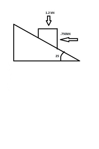

1. Homework Statement
Determine whether the block shown is in equilibrium and find the magnitude and direction of the friction force when θ = 25° and P = 750N
μs[\SUB] = .35
μk[\SUB] = .25
2. Homework Equations
Fs = μs * N
Fk = μk * N
3. The Attempt at a Solution
Attachment 1 up there is the drawing of the scenario.

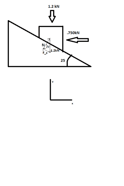

Attachment 2 is my addition to it to solve this problem.
Using the axis shown, I have
ΣFy = Ncosθ - Fssinθ - 1.2kN = 0
and apparently
ΣFx = Nsinθ - Fscosθ - .750kN = 0
otherwise that similar triangle I drew there wouldn't make sense, just odd to think of the force of friction acting in the SAME direction as the force...regardless, continuing...
Solving Top equation for Fs[\SUB] I get
Fs[\SUB] = (Ncosθ - 1.2kN)/(sinθ)
And subbing that into the second equation for F I receive
Nsinθ - ((Ncosθ - 1.2kN)/(sinθ))cosθ - .750 = 0
Nsinθ - (Ncos^2 θ - 1.2kNcosθ) - .750 = 0
N(sinθ - cos^2θ) + 1.2kNcosθ - .750 = 0
N = (-1.2kNcosθ + .750)/(sinθ - cos^2 θ)
N = 0.8465kN
So Fs[\SUB] = .35*0.8465kN = .2963kN
Seeing as how this doesn't match up to the answer given, I'm not seeing where I went off...can anyone guide me in the right direction? Should I use a slanted axis?
I don't think anyones going to see where you went wrong.

Sooooo many unnecessary "subs"
You can compute N much more easily by looking at the components of the 1.2 kN and the 0.75 kN normal to the surface. The the value of .8465 kN is not correct.
Yes, switching to a coordinate system aligned with the surface makes things easy.
[qoute]... And subbing that into the second equation for F I receive
##Nsin(\theta ) - \frac{Ncos(\theta ) - 1.2}{sin(\theta )}cos(\theta ) - .750 = 0 ##[/quote]
yes
##Nsin(\theta ) - Ncos^2(\theta ) - 1.2cos(\theta ) - .750 = 0##
try again.
