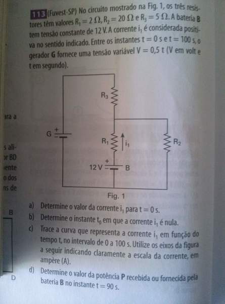

I'm trying to solve item "c" of this question about the electrical circuit depicted on the attached picture.
The question is in Brazilian Portuguese, this would be a rough and not 100% gramatically correct translation:
"In the circuit shown below on Pic. 1 (labeled "Electrical Circuit"), the three resistors have values [itex]R_1[/itex] = 2 Ω, [itex]R_2[/itex] = 20 Ω and [itex]R_3[/itex] = 5 Ω. The battery B has constant tension 12 V. The current [itex]i_1[/itex] is considered positive in the indicated direction. Between the instants [itex]t[/itex] = 0 s and [itex]t[/itex] = 100 s, the generator G provides a variable tension [itex]V = 0.5 t[/itex] (V in volts and t in seconds).
a) Define the current value [itex]i_1[/itex] for [itex]t[/itex] = 0 s
b) Define the instant [itex]t_0[/itex] in which the current [itex]i_1[/itex] is null.

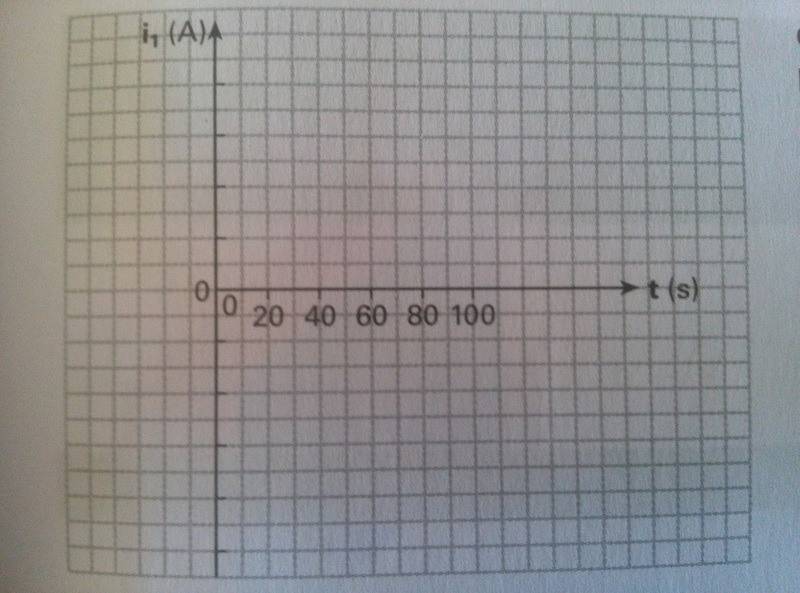

c) Plot the curve which depicts the current [itex]i_1[/itex] in function of the time [itex]t[/itex], in the interval from 0 to 100 s. Use the axis from the following picture (labeled "Graph") and clearly indicate the scale of current, in ampère (A).
d) Define the value of the power [itex]P[/itex] received or provided by the battery [itex]B[/itex] in the instant [itex]t[/itex] = 90 s."
I was able to solve items a, b and d using Kirchoff's Voltage Law and generating a linear system with two variables, [itex]i'_1[/itex] and [itex]i'_2[/itex], where [itex]i'_1 \pm i'_2 = i_1[/itex] and [itex]i'_1[/itex] is the current flowing around the left loop (loop I) and [itex]i'_2[/itex] is the current flowing around the right one (loop II). So:
a) 2 s;
b) [itex]t[/itex] = 30 s (in this case, [itex]i'_1 = -i'_2[/itex];
c) ?
d)[itex]P[/itex] = (I need to find the graph of [itex]i_1[/itex] vs. [itex]t[/itex] so I can calculate the absolute value of the power).
I wasn't able able to answer item c, because it asks to plot the graph of [itex]i_1[/itex] Vs [itex]t[/itex]. The issue is that [itex]i_1[/itex] is actually the algebric sum of [itex]i'_1[/itex] and [itex]i'_2[/itex], but I also have a third variable which is the tension [itex]V[/itex] generated by the voltage source G, which is a function of time [itex]t[/itex]. I don't have a third equation though, as Kirchoff's Voltage Law applied to the largest loop provides me an equation which is simply a linear combination of the equations associated with loops I and II.
According to the book answers section, the answer for item c) is a line of slope-intercept form [itex]f(t)= -\frac{t}{15}+2[/itex]. Then, |[itex]P[/itex]| would be 48 W. But how do you define [itex]i_1[/itex] as a function of [itex]V[/itex] and, consequently, [itex]t[/itex]?

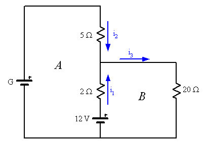

Just fill in unknowns for voltages along the various wires. There are three of these. Also an unknown for the current through each resistor.
You should get an equation relating these to the drop across each resistor and two more for the drops across the voltage sources. Finally, an equation relating the three currents.
Eliminating the extra unknowns should produce an equation for i1.

The only variables you have for your mesh analysis are the two mesh currents, ##i_a## and ##i_b##. ##i_1## is a derived value that you will later calculate from ##i_a## and ##i_b##, and V will take on values that come from its definition (V = 0.5t). For now treat V as a constant and lug it around in the equations as such.
So, standard mesh analysis to find ##i_a## and ##i_b##. You will end up with expressions for these currents involving V.
Alternatively, use bare-bones KCL and KVL. Define the other two currents ##i_2## and ##i_3## and write KVL for the two loops and KCL at the node:
You'll have three equations in the current unknowns. Use elimination to solve for ##i_1##.
