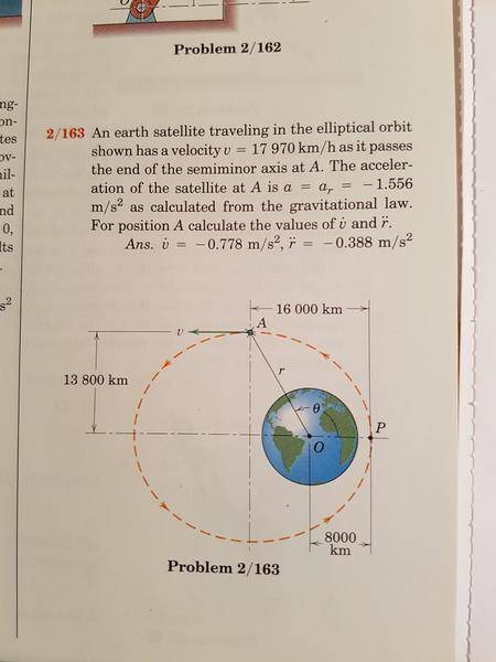

Formulas for a_r and a_theta.
I got the second derative of r but I think the fluxie v is a mistake. I am sure that
[itex]\dot{v} =a\[/itex], right?
The statement of the question is rather unclear. If v is the velocity, dv/dt is a vector, but it doesn't ask about the direction. Maybe it means to ask for ##|\dot{\vec v}|##.
The given acceleration appears to be the radial component only, so is not the same as either ##|\dot{\vec v}|## (the total acceleration) or ##\ddot r##.
Yes but the radial acceleration is the total acceleration [itex]a =a _r[/itex] so it should be the same right?
