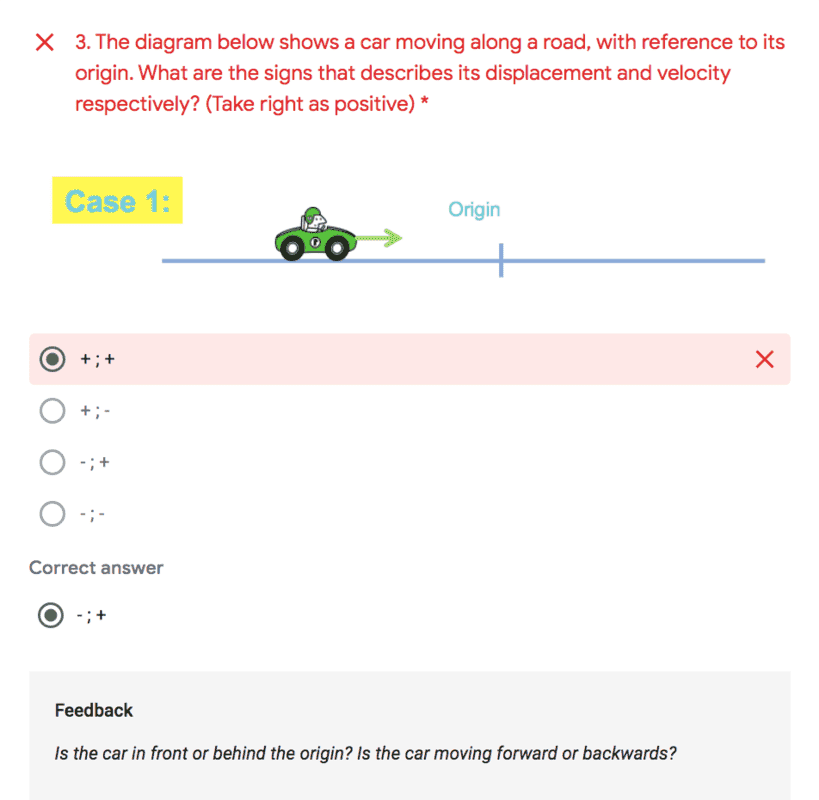

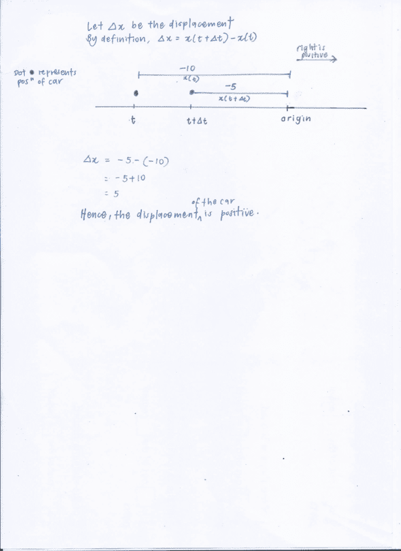

I have an issue with my physics teacher about a question on displacement. I have inserted the screenshot of the question below. By the definition of displacement, I was sure, and still am sure my answer is correct. But my physics teacher insisted that I am wrong. Please, can anyone help me explain who is right? I have also inserted my argument that supports my conclusion. Thank you.
My solution:

IMO, the question could be worded better if "position" was asked for rather than "displacement." Displacement implies a movement from one point to another, at least the way I think of it.
In the figure, the initial position is negative, and the velocity is positive.

You are correct and your reasoning is correct. Does your teacher even know the equation for average velocity?

It should ask for the initial displacement from the origin. The displacement changes with time; and displacement is generally relative to some point.

Oh I see now. The origin is not the origin of some arbitrary coordinate system as we typically use it. It is literally the origin of the car, because he uses “its” and not “an”. Technically, your teacher is correct. But why play silly word games like that?

The teacher has interpreted "displacement" as initial displacement from the origin. The OP has interpreted "displacement" as "the displacement over time from the starting position of the car".
PS just to add that I would interpret "position" as a point in space, independent of coordinates. Once you choose your coordinates, then the initial position of the car is either at the origin or displaced from the origin, as it is in this case.

In this case, the teacher intends “displacement” to mean “vector from the origin” while you intend “displacement” to mean “vector from the original location”. Both meanings are acceptable, so I would not present it as “right” or “wrong”. I would just tell the teacher that the question was ambiguous.

I agree that this is an issue of "displacement" being meant to be "position". Displacement is the change in position.
BTW, be careful that Δx is often defined as xf - xi. It looks like in the OP's explanation, he/she did xi - xf.

I will add to the growing litany of support. Displacement is final position - initial position. In this case the most reasonable interpretation is that the displacement is purely to the right = positive as you rightly argue. The fact that the question says “it’s origin” is bad english : unclear antecedent, the car’s origin or the road’s origin? This can be interpreted to mean the car’s origin, and the displacement would then be as your teacher suggests. However, that would imply some earlier time before the problem begins when the car originally started off at that zero point. That interpretation is patently ridiculous. You would be required to assume something that isn’t stated in the problem. That would be nothing short of stupid. I can see why this is bugging you.

The car is being displaced towards the right, and the question says to take that direction as the positive direction.
The position is negative, the displacement (defined as change in position) is positive.

The question says that the origin is “its origin” meaning the place that the car started. So it’s change in position is indeed negative.

The change in position is ##\Delta \vec{e}_x=v \Delta t \vec{e}_x##. Since ##v>0## the change in position (or more clearly the change of the component of the position vector with respect to the chosen basis) is positive.

"+;+" could never the the correct answer because it would imply that the car's [initial] displacement would depend on its actual velocity. How could that be?
If displacement were supposed to refer to motion from the 'position' at t=0 then surely the initial 'displacement' would be Zero,. That would be ridiculous because the option does not exist in the list of alternatives and it also implies that there would be something 'special' about starting at the origin (when t=0). Ignore all the extra discussions about equations of motion etc. etc.; they just add confusion. You should start with the data you are supplied with and deal with that first. The logic leading to the 'correct' answer should be would have to be the same for all possible starting positions (displacements) and velocities.
