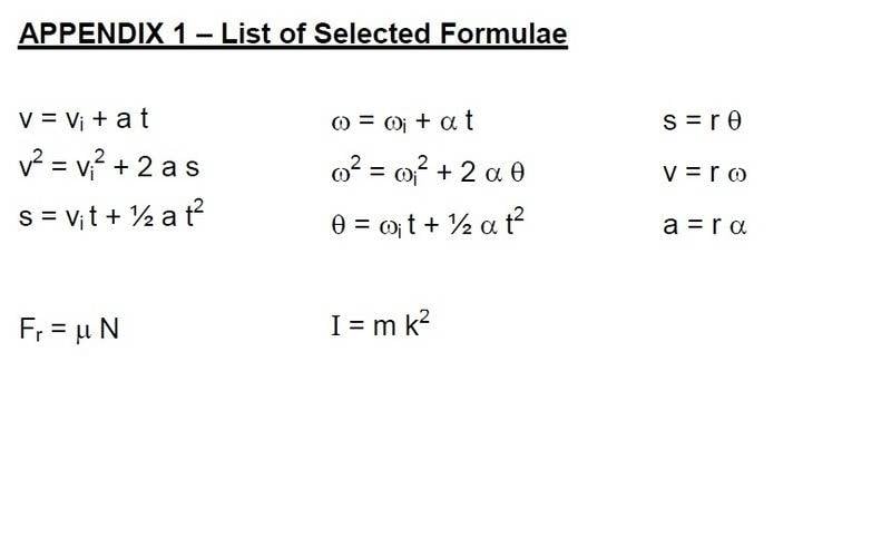

Is 2nd segment vi=16.67m/s v=16.67m/s a=0m/s^2 ?
How do i calculate the time when my acceleration is 0 for segment b?
ω=ωi+αt,v=vi+at
a times t = 0
No t in the equation anymore..:redface::cry:
It's constant velocity motion: distance = speed * time.
my book only has this formula.. no wonder i keep getting stucked..
So S=d/t is the only way to solve?
Thanks btw Doc Al
What formula? The attachment was blank.
That's the basic definition of speed, so sure.
The equation you want from your list is:
s = vit + 1/2at2
(s is distance, of course.)
Just plug in a = 0.
Ah... yea why didn't i see that hehe.. i understand already, thanks for the help..
