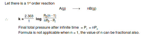

When i was flipping through a physical chemistry book I found a formula which looked like
How ever I am clueless to what it is
Can anyone explain what it is for
And possibly Derive it
Thank you
Flipping, eh ?
Google first order reaction rate
This must be for an isothermal reaction.
In which case, when n = 1, if the pressure is P0 at the start what is it at t = ∞ ?
The pressure kinetics is exceptionally easy, not to say degenerate. :oldlaugh:
I don't know why I am that dumb but i haven't been able to derive it at all
Maybe you are looking for something too clever or complicated.
If all the chemical reaction is one molecule of A producing one of B, then there is just no change of pressure.
