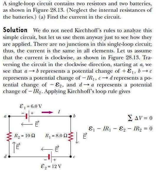

Circuit schematic of a single loop with two resistors (R1 = 8.0 Ω, R2 = 10 Ω) and two batteries (E1 = 6.0 V, E2 = 12 V), current I shown clockwise, with electric field arrows along the wires and a loop-rule equation E1 - IR1 - E2 - IR2 = 0.
I have drawn the direction of the electric field in the picture.
I saw this on a video on youtube where this guy solves circuit problems solely on looking at the direction of the electric field. Basically he follows the current and the electric field
$$-\varepsilon_1 + IR_1 + \varepsilon_2 + IR_2 = 0$$
What is the different theory behind the approach? Is it a coincidence that they both will give the same answer or is one of them wrong? For instance between $$b$$ and $$c$$, the electric field and the current is in the same direction so we have
$$\int_{b}^{c} \mathbf{E}\cdot d\mathbf{s} =\int_{b}^{c} Eds = -\Delta V$$
Which means the potential should be minus, but "according to Ohm's Law, the electric field and the current are in the same direction, so we get +IR" and in the battery we go "against the electric field, so we get $$-\varepsilon$$.
The circuit the guy on youtube () does involves an inductor, but I thought I could apply the same principle to regular resistor circuits. Does the equation $$\int_{b}^{c} \mathbf{E}\cdot d\mathbf{s} = -\Delta V$$ no longer hold? Note that the integral isn't a closed loop.
Thank you for reading
In your Kirchoff's analysis, you are using symbol E for the voltage across each component, so E has units of volts. Once you mark in a loop's current arrow, you can determine the voltage E across each component because to cause current to flow in a resistor in the agreed direction, one particular end of that component must be positive relative to the other.
In ∫E.ds the term E is the voltage gradient, in volts/metre. You don't know E in the circuit, nor s, so this equation is of no use here.
