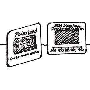

I'm recently looking for optical devices to do some experiments at home, like diffraction and polarization, but when I turn to Amazon for the goods, I found that both the sheets I want are marked: 500 lines/mm -- diffraction grating, and linear polarizing sheet(2nd picture of the product shows "500 lines/mm diffraction"). You can click the names to view the corresponding devices on Amazon. Note that this is absolutely not ads, I have to exemplify the dimensions. Maybe that "500 lines/mm" in the polarizing sheet link is not for the polarizer itself, I'm not sure.
This "500 lines/mm" confuses me, as the physics textbook says, if I want to observe diffraction, the dimension of the aperture should be comparable to the wave length of visible light(several hundreds of nanometers), thus apertures on the "diffraction grating" should suffice this criterion -- it's 2um/line = 2000 nm/line, and I think this is the interval of apertures, so "500 lines/mm" should be a good choice for diffraction grating.

Um ...Polarizers are made a different way to diffraction gratings. It is not a matter of having lots of finely spaced lines ... which you will see if you cross two polarizers then slip a third, at an intermediate angle, between them.
If the polarizer in your link is marked 500lines/mm I have not found it.
The second pic (reproduced below) is a sketch with a polarizer depicted on the left and a diffraction grating depicted on the right, labelled "500 lines/mm linear diffraction", which may have confused you.

For your purposes, though, the density of the lines mentioned in the ad is not related to the polarizer.
