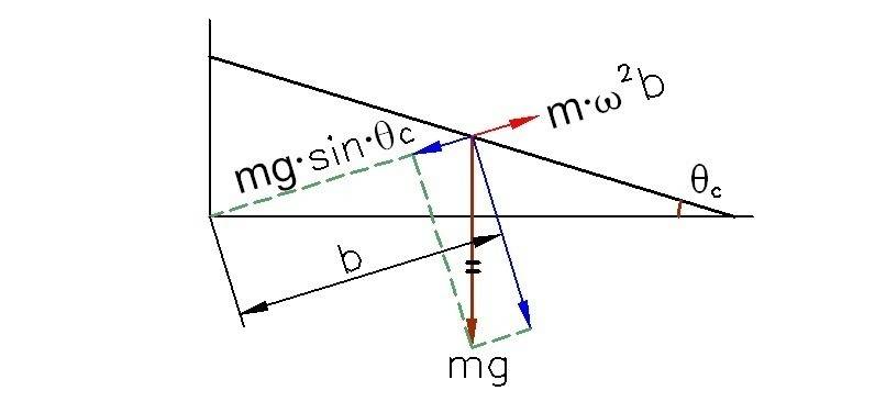

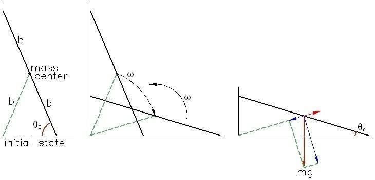

A ladder is leaning against a smooth wall and a smooth floor (no friction). it's starting to slide
down. The initial angle between the ladder and the floor is [tex]\theta[/tex]0, according to the drawing. The mass is m and length 2b.
It is clear that the distance from the center of mass to the corner is also b, and that the center of mass makes a circle when it moves.
At what angle does the ladder detaches.
I have a true solution and it is: [itex]sin\theta_c=(2/3)sin\theta_0[/itex], but I want to test another.
I also know the angular velocity of the ladder is the same as that of the center of mass around the corner and equals to:
[tex]\omega=\sqrt{3g/(2b)(\sin\theta_0-\sin\theta}[/tex]
and the angular acceleration is:
[tex]\alpha=\dot{\omega}=-(3g/4b)\cos\theta[/tex]
Centrifugal force: [itex]F_c=m\omega^2R[/itex]
If I dismantle the gravitational force mg into 2 components: one directed towards the corner and the other tangent to the circle equal the center of mass makes, according to the drawing, and I try to equal the component that is directed towards the corner with the centrifugal force:
[tex]mg\cdot\sin\theta_c=m\frac {3g} {\sin\theta_0-\sin\theta_c}b[/tex]
which gives a meaningless result.
Why isn't that principle good for this situation? it is the method for solving the problem of a point mass sliding down on a frictionless dome.

The initial energy of the altitude the final energy: the one of the altitude plus the kinetic energy of the center of mass plus the energy due to rotation around the center of mass:
[tex]mgb{\sin\theta_0}=mgb{\sin\theta}+\frac{1}{2}m{V_c}^2+\frac{1}{2}I_c\omega^2=<br /> mgb{\sin\theta}+\frac{2}{3}mb^2\omega^2[/tex]
Which yields:
[tex]\omega=\sqrt{3g/(2b)(\sin\theta_0-\sin\theta)}[/tex]

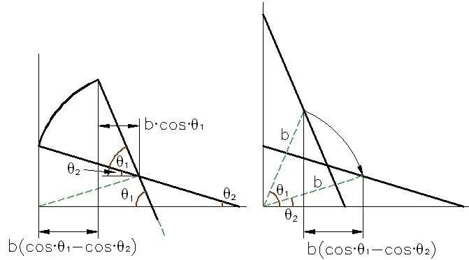

Is the angular speed ω of the CM about the corner the same as the angular speed of the ladder about the CM? Why is that?
Yes. that part I proved myself.

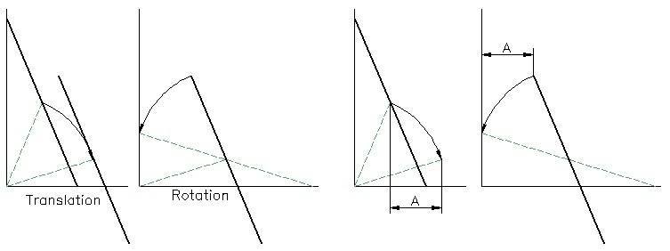

I dismantle (I'm not shure I'm usung the correct word, please correct me) the combined movement into two separate ones: translation and rotation, according to the drawing.
I assume the angle [itex]\theta[/itex] is the same for the two rotations, and measure the horizontal distance A the m.c. makes and the edge of the stick, of course in the opposite direction.
We see, in the drawing, that they are the same:
[tex]b(\cos\theta_1-\cos\theta_2)[/tex]

Secondly, I confirm that the angular speeds are fortunately the same :smile: So that's not the problem.
Is based on: [itex]\Sigma\mbox{F}=ma[/itex], where a is the centrifugal acceleration [itex]\omega^2R[/itex].
[itex]mg\cdot\sin\theta_c[/itex] is the component of the gravitational force mg, that is (the component) directed during the whole circular motion to the corner, the center of the circle the m.c. makes. The subscript c below the [itex]\theta[/itex] denotes it is at the detachment point.
See drawing.

3/ Again, you missed the normal force from the ground, or more exactly, the component of that normal force perpendicular to the ladder. [tex]\Sigma \vec{F}[/tex] must include it. Have a look at this:
http://en.wikipedia.org/wiki/Center_of_mass#Derivation_of_center_of_mass
The motion of CM is like that of a point mass which experiences ALL the external forces acting on the ladder (i.e. mg & normal forces), not just the forces acting at CM on the ladder (i.e. mg).
By the way, I think the last equation of yours in post #1 is a bit incorrect. It should be: [tex] mg\cdot\sin\theta_c=m\frac {3g} {\sin\theta_0-\sin\theta_c}[/tex]. No "b" included.
