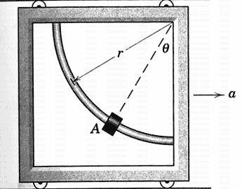

Initially collar is at rest with theta = 0. Find [tex]\dot\theta=f(\theta).[/tex] And find maximum theta reached.
I don't know if i allowed to use angular momentum about top-right frame corner as it's accelerating.
But i definitely will need second Newton law:)
I know that there mg, N forces. But i can't figure out another force due to acceleration of the frame.

The collar undergoes three forces - [itex]m\mathbf{g}, \mathbf{N}, \mathbf{F}_{ext}[/itex]. From which [itex]|m\mathbf{g}|=|N|[/itex], though i can't prove it.
With angle [itex]\theta[/itex] we have:
[itex]|m\mathbf{g}|[/itex] acting downward and [itex]\big(|\mathbf{N}| + |\mathbf{F}_{ext}|\big)\cos\theta[/itex] acting upward.
The maximum angle is reached with equilibrium.
And here i can't calculate the external force.

The external force acts on the frame, not on the collar.
Why do you think |mg|=|N|? Consider horizontal and vertical separately.

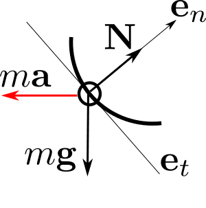

I can't come up with solution in [itex]\hat{i}\times\hat{j}[/itex] frame.
Maybe i need to consider tangential parts of [itex]mg[/itex] and anther force, i think this another force is [itex]ma[/itex]? When they become equal, then no more change of angle.
The original post said "Initially collar is at rest with theta = 0" and according to the picture "theta= 0" is at the bottom! The collar won't move- [itex]\theta'= 0[/itex]. If you intended to the initial point to be at the top, with "theta" measured from the top, then, at each [itex]\theta[/itex], the downward acceleration vector, <0, -g>, can be written as the sum of two vectors, one parallel to the normal vector circular bar and one parallel to the tangent vector. Since the collar can't move normal to the bar, only the tangent vector is relevant.
Have you noticed rightward horizontal acceleration of the frame?
That is the non-inertial frame method I mentioned. You treat the acceleration as a 'fictitious' force ma acting the other way.
So what answer do you get?
NO! I hadn't. Thanks.
