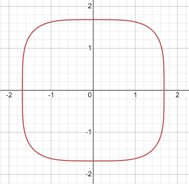

I am going so much slower and am looking at $$ \begin {cases}
2x+y+4\lambda x^3 & = 0 \\
x+2y+4\lambda y^3 & = 0 \\
x^4+y^4 & = 8 \end {cases}$$where I notice this set is symmetrical wrt ##x## and ##y##. That's so nice I already mentioned it in #4. Because I'm also completely useless when third and fourth powers appear in equations.
It means that if you solved the whole lot and marked the solutions on a graph, the picture remains unchanged when you swap the ##x## and ##y## axes. In short: the lines ##x-y=0## and ##x+y=0## seem interesting. Sure enough, on ##x-y=0## we have ##f = 3x^2## and on ##x+y=0## we have ##f = x^2##. Hmmm...
One of the reasons it took me a while to put this post together (several sheets of paper too :smile: ) Is that I had to dust off and mobilize some very old but solid knowledge:​
If we do a coordinate transform (rotate the ##x## and ##y## axes over ##\pi/4## :​
[edit]##\LaTeX## fumbling in progress :cry: Solution: the automated BB INDENT stuff is in the way ?: And it comes back everytime I insert e.g. a blank line ?:)
$$\begin{bmatrix} x'\\ y'\end {bmatrix} = \begin{bmatrix} {\frac 1 2 \sqrt 2 x} & {\frac 1 2 \sqrt 2 y} \\{-\frac 1 2 \sqrt 2 x} & {\frac 1 2 \sqrt 2 y} \end {bmatrix} \Rightarrow
\begin{bmatrix} x\\ y\end {bmatrix} = \begin{bmatrix} {\frac 1 2 \sqrt 2 x'} & {-\frac 1 2 \sqrt 2 y'} \\{\frac 1 2 \sqrt 2 x'} & {\frac 1 2 \sqrt 2 y'} \end {bmatrix} $$​
then​
$$x^2+xy+y^2 = \frac 3 2 x'^2 +\frac 1 2 y'^2 $$ (all that paper ... ) so we have a contour plot of ellipses, stretched in the ##y'## direction.​
The graph of ##x^4 + y^4## is a deformed circle ("kurtosed" might be a nice term :smile: but a short search yields a superellipse or Lamé curve with the name Squircle -- How I love the internet :kiss: ) :​
( picture courtesy of https://www.mathway.com/Algebra)​
So we are tempted to declare the intersections of this squircle and ##x-y = 0## as the top value winners of our maximum search !​
Not really a case of straight ahead equation solving ! One could say: Much better with mix and match !​
Of course a despicable cheater would leave all the work to the internet and get an answer too ... including the rotated ellipses and the squircle and ...​
This was real fun ! Look forward to the next one :cool:

It's really cool solution though, did you get the answer:
##max: (\sqrt{2}, \sqrt{2}) = 6, min (0,0) = 0##?
And after a good nights sleep I feel a little less smug. After all this advertising Lagrange and then not finding an honest way to find e.g. ##\lambda## (why ##-\frac 3 8 ## ?), I share the nagging feeling in #11 and #12.
But it was fun, and perhaps the next one is more forgiving :wink: ?

Good point. Useless showing off :woot:. Put it down to vanity. Or stubbornness: I wanted to see these ellipses emerge or else I wouldn't be able to sleep :-p.
Even so I have no idea how the final equation of a kurtose would make anything easier. Now you got 2 unknown variables and their derivatives to work with. Even worse!
I disagree: once I can see the ellipses I know I want te be on the short axis and as far away from the origin as possible to get a maximum, so on ##x = y## and there ##2x^4=8## gets me, you and wolfram the same answer:
A cool solution, indeed :cool: !
Nevertheless, someone showing all of us a decent analytical way to actually find these ##\lambda## will earn my everlasting gratitude !
Homework (easy!) for you:
  • show us ##\vec\nabla f## and ##\vec\nabla g## at these maxima and see that they are collinear :wink: indeed.
  • same for the other two local maxima
