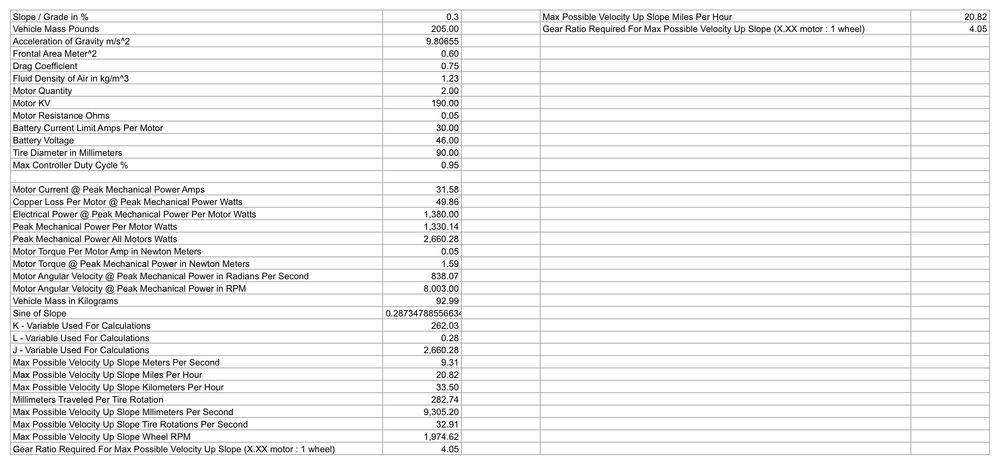

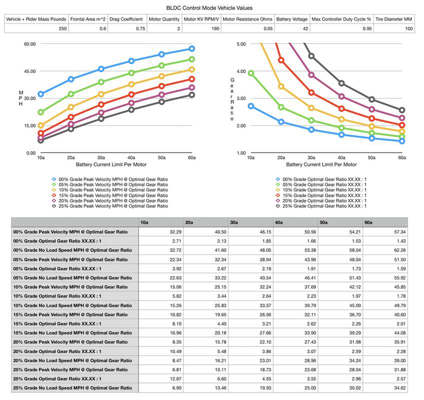

Would it be acceptable enough to use a downloadable spreadsheet format? (it strips off the extra zeros while retaining them in memory)
Spreadsheet: https://files.secureserver.net/0fT5HhdTQhpC24
Spreadsheet: https://files.secureserver.net/0fhemIK29ta5TN
No. You are still not explaining in words what you are doing and why you think it is the right thing to do. If you cannot be bothered to do this, why would you expect me to be bothered to figure it out?

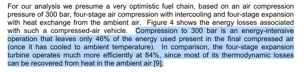

What that video shows is that the ball that spends more time with reduced GPE (gravitational potential energy) spends that time at higher speed. If the path distance doesn't increase as much as the increase in speed, the ball's average speed is higher. This is clear in the first comparison, where there is a single drop at the start and a single rise at the end. What wasn't shown in the video is a path where the tops of the peaks are higher than the straight line path, where part of the time is at a higher GPE. An obvious example would be a single rise at the start, a straight line, and a single drop at the end. There's a path where the average GPE on the curved path is just decreased enough to compensate for the longer path, in which case the time from point A to point B would be the same. If the average GPE doesn't compensate for the longer path, the curved path takes longer. Note that this is a comparison of time, not of efficiency.
Getting back to the original question, unlike a rocket in space, an object operating in the atmosphere doesn't get the same increase in velocity (delta v), from the same impulse (force · time), due to drag, and the atmosphere reducing the "exit velocity" of the exhaust from the compressed air tank.
The unknown here is the efficiency of an electric motor used to drive a pump to compress air into the tank, and at what speed such a setup would be most efficient, taking into account all of the energy losses.
Another example would be a jet engine based land vehicle. Since jet engines are more efficient at higher speeds, than a path that involves spending more time at the jet engines ideal speed (taking into account drag), should be more efficient.
