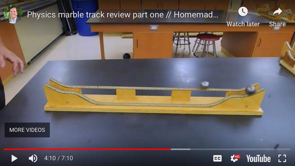

"So if a spacecraft is on a parabolic flyby of Jupiter with a periapsis velocity of 50 km/s and performs a 5 km/s burn, it turns out that the final velocity change at great distance is 22.9 km/s, giving a multiplication of the burn by 4.58 times."
https://en.wikipedia.org/wiki/Oberth_effect
And it's not magic. And it conserves energy. But it leaves the fuel which started with high potential energy and high kinetic energy down lower in the gravitational well with reduced potential energy and reduced kinetic energy.
You cannot pull that same pet trick using compressed air in an atmosphere.

Assuming this is true then how does the marble in the video reach the other side quicker? (the one that spends time at lower altitude)
  • #46
Remember what problem you are solving. You are trying to optimize energy expenditure for a fixed transit time under quadratic drag. If you have been paying attention, the version of the problem that I have been taking pains to address is one with a running start and a running stop. That is the problem with an optimal solution that cannot be improved upon.
Optimizing transit time with zero energy input, negligible resistance and a start from rest is a different problem. Brachistochrone
If one were trying to optimize transit time with fixed energy input (elevation difference between start and finish), quadratic drag and a start from rest, one would expect a curve with an initial dip, a near constant slope and a final rise -- a flattened Brachistochrone curve.

So if that’s true how does the marble in the video that takes the lower ramp get to the other side quicker with the same initial height and same ending height?
4min07sec:
  • #58
Stop changing the scenario. I already answered that same question with this same answer.

This doesn't appear clear to me. To start with, isn't the combination of these two scenarios physically impossible/contradictory?
Second, from the video of the balls rolling on the tracks it is clear to me that the deeper the curve the faster the transit from point A to point B for a case where drag is insignificant - and I don't think this is a different scenario from what you answered. I'm not convinced that non-zero drag instantly changes things -- I think there's a threshold of drag vs mass, on one side of which the curve helps and on the other side it hurts. But let's take this step by step...
Zero drag, flat vs curved. That's what the video shows, right? And the curved track ball gets to point B first, right?
