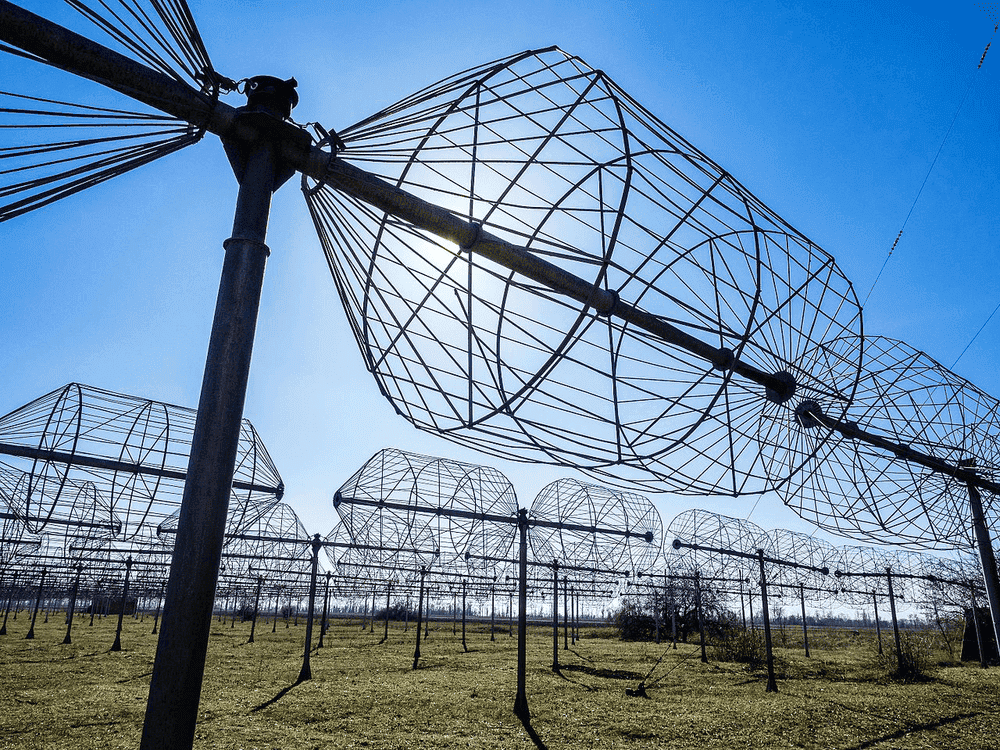

Interestingly, the thickness of a dipole wire will affect the bandwidth. Fat dipoles tend to be used in wide band multi-element arrays because they match better. They don't need to be as fat as the ones below to be worth using.
Image of fat ( cage) dipoles from Wikipedia

Interesting thread. How does the thickness affect the bandwidth? After high enough frequency doesn't the signal travel mostly on the surface (skin depth)?

Regarding conductor diameter and bandwidth, the main issue here is that the conductor is resonant, so we start to see unwanted reactance when we move away from the designed frequency.The antenna conductor can be considered as a transmission line resonator where the characteristic impedance, and hence the Q, is lowered by using fat conductors. By using low characteristic impedance the Q is lower and the bandwidth is increased. Hence the use of fat conductors.
The reason we see resonant action in an antenna is that when we accelerate electrons, not all the energy is radiated. The electron also acquires considerable kinetic energy. It is this unradiated energy which is deposited in the antenna capacitance. Half a cycle later it leaves the capaitance and moves to the antenna inductance, where it is stored in the antennas local magnetic field. It is these storage places, electric and magnetic, which represent the strong induction fields which we find close to the antenna. In a typical case, only 10% or the power is radiated each cycle, the remainder being stored.

For a thin wire dipole, the Impedance passes from largely negative reactance, through pure resistance to positive reactance. See fig2 in this link For a fat dipole that reactance curve has a smaller slope around the resonance frequency and that widens the bandwidth over which you have largely a resistive component.

That curve looks like normal transmission line theory, but the figure doesn't show (or it's not apparent to me) how the thickness of the metal affects its impedance; I also don't understand why skin depth doesn't apply to "ordinary" antennas. Is the frequency just too low? If it requires much more detail then I'm willing to start a new thread as I don't want to hijack this one, but maybe OP might be interested since the whole idea of skin depth is that the current does not distribute equally across the cross-section... at what point would their approach break?
edit:
Found the above to be true in my textbooks although I felt the explanation fell short with "It is an important general principle that the thicker the dipole, the wider is its bandwidth." My question isn't so much about whether or not it's true, but more of how or why? Would this still apply at higher frequencies?

The effective C and L of a thick cylinder are not the same as that of a thin wire so you are dealing with a different transmission line. The R at resonance is still about the same though. But this takes us beyond the first layer of antenna theory. I would bet that the original work on antennae was very experimental and the theory 'caught up with' that later. The relationship between wire thickness and intercepted power from the wave is not obvious. An infinitely thin wire shouldn't actually intercept any power, thinking intuitively.

Why is bandwidth greater with a thicker conductor? If you consider the antenna as a transmission line, a thicker conductor gives a lower characteristic impedance (Zo). This is because the capacitance, which shunts the line, is greater for the thicker conductor. When the transmission line resonator moves away from resonance, the reactance it presents is less with the lower Zo. It is similar to an LC circuit with high C.
This lower reactance is in series with the radiation resistance of the antenna, so that the feed point impedance is less disturbed.
For example, a wire which is an 0.2 of a wavelength long (72 degrees) has a radiation resistance of, say, 20 Ohms. If it is thin and has a Zo of 1000 Ohms then it will present a capacitive reactance of Zo/tan 72 = 333 Ohms. So the feedpoint impedance is 20 - j333. On the other hand a large tube having a Zo of 100 Ohms wil present a capacitive reactance of Zo/tan 72 = 33 Ohms, so the feed point impedance is now 20 - j33. If we have a 20 Ohm resistive source then the latter case is a far better match.
