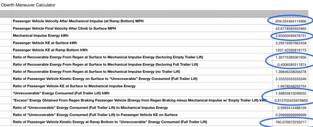

I see the goal at this point as finding a certain slope and oberth boost, if possible, that gives a consistent start and end velocity, and takes the same time from A to B as constant surface velocity, in order to compare with the wheel driven surface vehicle.
Oberth gives no advantage relative to wheeled propulsion. There is no possibility of improvement on the constant speed powered surface trip.
Do the energy accounting. Any Earth-relative exhaust velocity other than zero will result in energy being wasted into the exhaust stream. An Earth-relative exhaust velocity of zero is equivalent to wheeled propulsion.
I thought with wheeled propulsion, it takes increasing mechanical power to maintain constant thrust at increasing speeds, because the ground (reaction mass) is moving away from the vehicle faster as the vehicle travels faster. But with the rocket, the reaction mass (compressed air) has 0 velocity relative to the vehicle at the moment before it is expelled, so I thought it took less chemical energy to obtain the same kinetic energy when the rocket travels at very high speeds.
You are picking up the air from the atmosphere where it starts with zero Earth-relative velocity. You are then accelerating the air to vehicle speed. That takes energy.
If you proceed to expel the air at an exhaust velocity less than the vehicle's Earth-relative speed, you have a net loss of momentum -- you are slowing your vehicle down. If you expel the air at more than the vehicle's Earth-relative speed, you have a net loss of efficiency compared to wheeled propulsion.

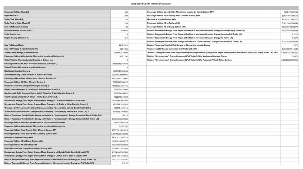

Trying to simplify the problem as much as possible. Suppose I want to cover 10 miles on the surface at 100mph. I design a wheel driven car that goes 10 miles at 100mph with a certain amount of chemical or electrical energy -- the car is accelerated with outside means initially to 100mph before the start of the 10 mile straight track (flying start), and does not brake when crossing the finish line, and it gets a certain efficiency.
Next I design a track where the same frontal area, drag coefficient and initial mass car (locked to rails) is also first accelerated by outside means to 100mph, where it then enters a 45 degree downward slope to a depth of 2.5 miles, the track flattens out for a distance, and then climbs out via another 45 degree angle track to the point on the surface that is 10 surface miles from the starting point (smooth curves between the different angled sections). This vehicle has to expend enough energy via its rocket nozzle immediately after entering the flat section at the bottom of the tunnel that it crosses the finish line at 100mph -- but there is the added complication that it needs to cross the finish line at the same time as the other car that went constant speed on the surface. Does this second vehicle need to ride over an above ground hump to slow itself down enough to cross the finish line at the same time as the constant speed vehicle?
  • #75
So the surface car runs at constant 100 mph speed through the entire track and completes the course in precisely six minutes. The energy budget for the surface car is dictated by air resistance. Elsewhere you have assumed quadratic drag for this.
The sub-surface car covers a total distance of 2.5√2+5.0+2.5√22.52+5.0+2.52 ~= 12 miles. Accordingly, its average speed must be 120 mph. Given quadratic drag, this means that the sub-surface car dissipates about 44% more energy to air resistance than does the surface vehicle.
If we assume an exhaust velocity of about 5000 miles per hour and a vehicle velocity of 100 mph, the energy in the rocket fuel would be delivered about 98% to the exhaust and about 2% to the vehicle.
At 120 mph, we are improving things slightly. Now we get about 97.7% to the exhaust and 2.3% to the vehicle. But that's not enough to make up for quadratic drag. [2.5 miles of vertical drop is enough to get much faster speeds. But quadratic drag grows faster than Oberth can catch up].
None of that was part of your immediate question though. You wanted to know about the hump at the end.
There is nothing that stops us from turning the track upside down and having the vehicle run inverted at the start and end of the trip so that it can shift from straight-and-level to downslope and from upslope to straight-and-level. That detail is uninteresting from the point of view of an energy analysis.

So now you finally have a scenario that works.
In vacuum, there is no air resistance. The energy budget for both surface and sub-surface trips is exactly zero. You get a win on transit time by putting a dip in the trajectory. And you can discard the rocket motor.

  • #86
jbriggs444 said:
Quadratic drag still trumps Oberth.
How can this always be true when in the video at 4:07, the marble that takes the "low road" then climbs back to the original height covers a longer path at a higher speed with the same amount of energy. So if I make the tunnel a vacuum can I go anywhere on land in the least time for the least energy by riding down 45 degree ramps to straight sections of track in vacuum tunnels which are ~ 2.5 miles deep?
  • #87
This is the pertinent still frame:
  • #88
For the n'th time, that's not Oberth and it's not saving any energy.
That scenario involves a [nearly] lossless situation. The energy use for both high road and load road is nearly zero. If one were to do careful measurements however, one would find that the low road consumed more energy than the high road.
If you cover a longer path in a shorter time, you will have a higher average speed.
If you travel a longer path at a higher average speed you will tend to experience more drag and dissipate more energy.
Roughly speaking, Oberth buys you a linear increase in propulsion efficiency. Double the speed and you double the efficiency. Roughly speaking, quadratic drag costs a cubic increase in energy dissipation. Double the track length for a fixed transit time and you pay eight times the energy. Reduce the transit time and you pay even more.
