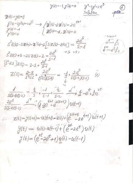

Hi everybody,
can somewone tell me where am i wrong in this solution?(attached here)
thank's

hedipaldi said:
Hi everybody,
thank's
Well, if [itex]e^t \longrightarrow 1/(s-1),[/itex] then [itex]e^{t+1} \longrightarrow e/(s-1),[/itex] not [itex]e^s /(s-1).[/itex]
RGV
