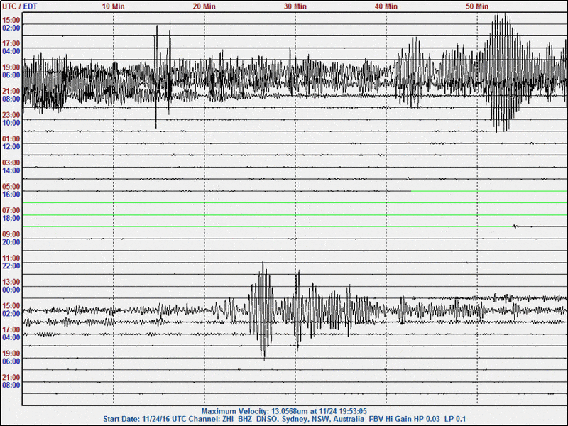

the latest 2 events recorded by my system
The top event is the M 7.0 offshore Nicaragua / El Salvador
M 7.0 - 149km SSW of Puerto El Triunfo, El Salvador
Time 2016-11-24 18:43:48 (UTC)
Location 11.960°N 88.836°W
Depth 10.3 kmthe lower event is a M 6.6 from Tajikistan
M 6.6 - 49km ENE of Karakul, Tajikistan
Time 2016-11-25 14:24:29 (UTC)
Location 39.238°N 74.047°E
Depth 12.6 kmcheers
