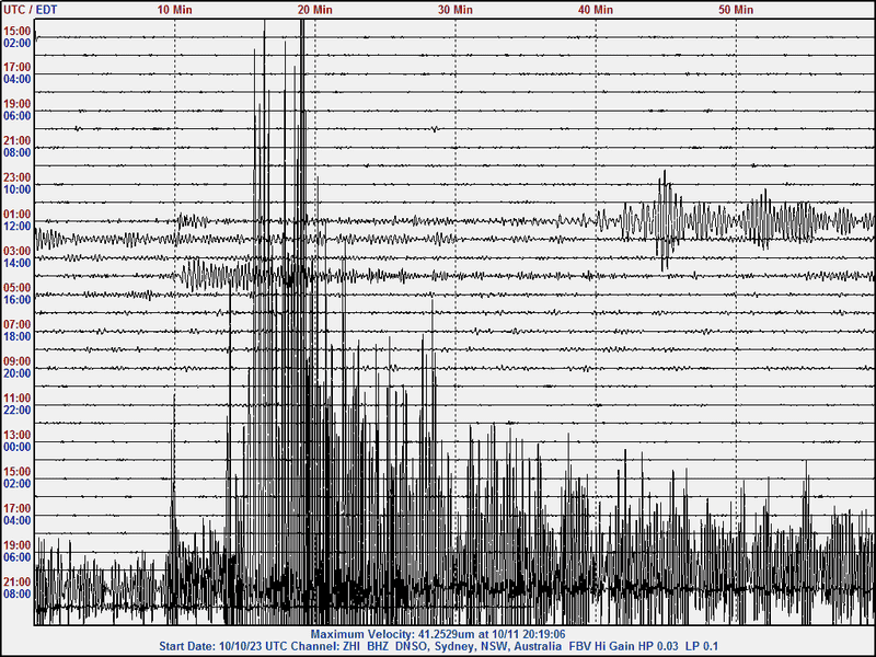

From my seismograph this morning
M 6.3 - west of Macquarie Island
2023-10-11 20:04:57 (UTC) 52.060°S 139.590°E 4.8 km depth
This is on the Australian - Antarctic Ridge boundary, South of Australia.
The 3rd and latest M6.3 from Afghanistan can also be seen further up the seismogram.
The P wave arriving at 01:10UTC.. The origin time of the quake was 00:41:56 UT meaning that it took
some 28 minutes for the P wave to travel from the quake focus to my location in Sydney
The other smaller event after the Afghanistan event was a M5.5 from the Balleny Isl. area, in the Pacific - Antarctic Ridge

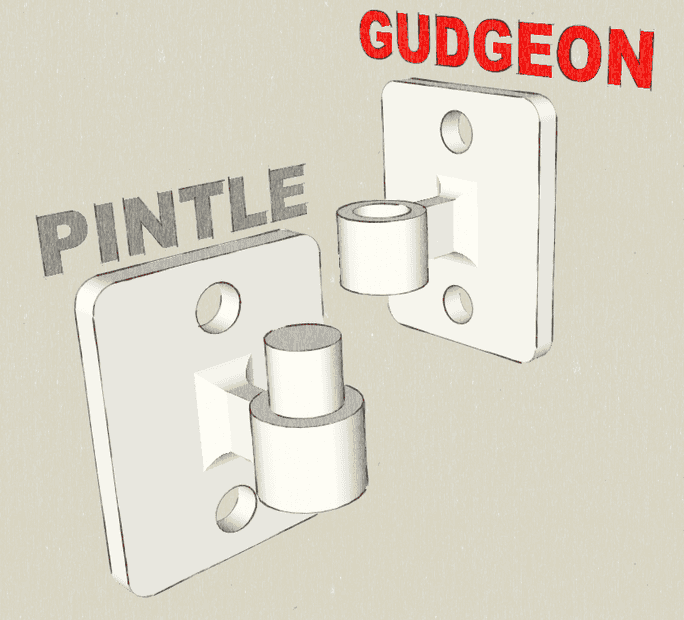

As a place name, you should capitalise "High Dungeon".
Maybe you are in "high dudgeon" ?
