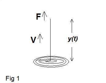

The following came from a discussion about launching a balloon.
Suppose you have a heavy coiled rope of total length, L, and constant linear density, MU. You take hold of one end of the rope and pull it vertically up with a force, F(t), so that the tip of the rope moves at a constant velocity, v.
What is F(t), assuming the rope is so long that some of it remains coiled on the ground?
In drawing our free-body diagram, two questions arise:

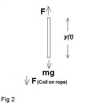

1) Can you define our system to be just the vertical length of rope (of length, y(t)) --- see figures 1 & 2?
2) If so, how do we calculate the force that the coiled portion exerts on the vertical section, F(coil on rope)? There must be a force, otherwise the coiled portion wouldn’t unwind.
Thanks in advance.

Is this a homework question? Do you have any work to show us?
As a hint, though, it may be useful to delete the velocity from the free body diagrams and consider the difference between the two static scenarios...
No. It is not a homework question!
You'd know the rate of mass flow transitioning from not moving to moving upwards at the fixed velocity. There's a period of time where the speed of the unwinding rope is faster than the upward velocity, because it also has a horizontal component.
The unknown is the amount of time it takes for each section of the coiled rope to transition into upwards movement, specifically, the relationship between acceleration and time of the rope as it unwinds.
As time goes on, the mass of the rope moving vertically increases, while the mass of the rope sections in transition remains near constant, so the limit of this is simply the weight of the suspended rope as it moves at constant speed.
You could simplify this by having the rope on a drum unwinding at constant speed, eliminating the transitional acceleration of the rope.
What I was wondering about was that the system is not fixed. IE Can we define our system to be the vertical length of rope even though the length of rope increases?
Using a drum that the rope unwinds from approximates this, as the rope no longer experiences any linear acceleration as it spools off the drum, and if the drum is friction free, it's not adding any load to the system. The effective diamter decreases as layers of rope are peeled off, but this can be ignored to simplify the problem.
Does this mean we could apply Newton's second law to the vertical section of the rope ("our system") as:
F(t) - m(t)g - Force(coil on rope) = ma
where we take Force(coil on rope) = 0
and a = 0 (as rope rises at constant vertical velocity)
Yes, in which case, F(t) = m(t)g.
