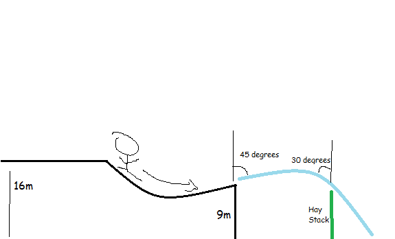

A skier goes down a slope and goes over a ramp. From a resting position which has a height of 16m, she leaves a ramp of 9m at an angle of 45 degrees and passes over a haystack forming a 30degree angle vertically. Supposing there is no friction and that the skier's dimension are negotiable, find the height of the haystack.
I attached a drawing of the problem also.

Welcome to PF, hasik.
I'm not quite following your calc. I'm thinking potential energy is converted to kinetic as the skier falls 7 m.
mgh = ½mv²
v = squareRoot(2gh) where h = 7
for the speed of the skier leaving the ramp.
The rest of the question isn't entirely clear to me!
In the diagram, it looks like we must find the height where the trajectory is 30 degrees from vertical. But the trajectory angle will then get closer to vertical as it goes further and hit the side of the haystack, contrary to the words in the question ("passes over a haystack"). What do you think - does that haystack "form a 30 degree angle" or is it shaped like a post as shown in the diagram?

the haystack is a post. The 30 degree angle is formed by the skier.

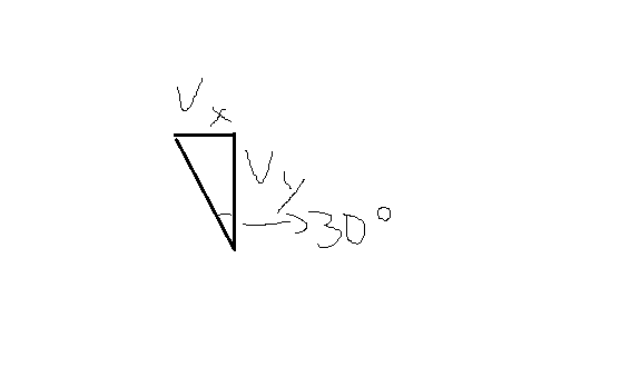

You want the time when the velocity vector is at 30 degrees to vertical.
Sketch Vx and Vy vectors on a triangle, put in the 30 degrees and you'll get a trig ratio relating Vx and Vy. Solve that for t.
You only have the angle, which is 30.
How can you possibly calculate Vx and Vy??
tan(30) = Vx/Vy
Put in the equations you have for Vx and Vy.
Solve for t.
With the known time, you can find the x or y position you need!
So :
tan(30) = 8.3/Vy
Vy = 8.3/tan(30)
Vy= 14.4m/s
V2y = 8.3 -9.8t
14.4 = 8.3 - 9.8t
t= 0.622s
y = 8.3t - 4.9t^2
y = 8.3(0.622) - 4.9(0.622)^2
y = 3.26m
Therefore the haystack is 3.26m high??
Looks good!
