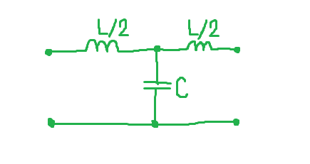

Hi!
Here is my task:
Lowpass filter circuit is given:

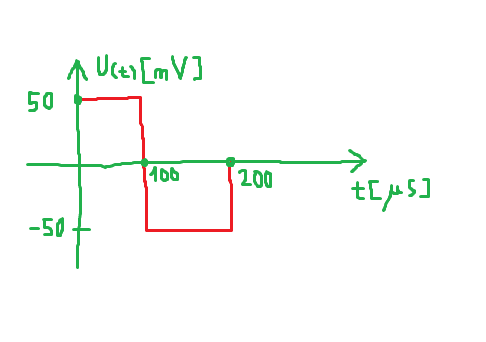

Input signal to this circuit is:
L=36.4mH, C=85.4nF.
Calculate and draw output signal.

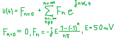

1)
Here is input signal in term of Fourier series (complex form):

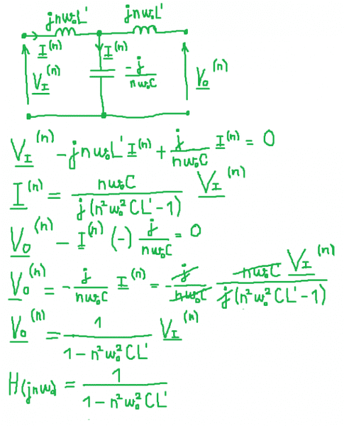

2)
Here is transfer function for n-th harmonic:
(L'=L/2)

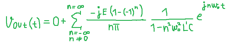

Output signal is now:
First question: what is purpose of second inductor? We don't take into account when calculating transfer function.
Second question: If I plot output voltage I calculated, it doesn't match with voltage I got in simulation software? Why?
Does it have something with location of pole of transfer function? Pole of our transfer function is on imaginary axes.
The inductor on the right achieves nothing without there being a load of finite impedance. With an open-circuit load, as you show, the second inductance does nothing.
Are you sure there isn't supposed to be a load of some specified resistance?

Your input signal here, is it just these two pulses then nothing, or is this waveform going to be repetitive?

I'd be tempted to use the non-complex version of the Fourier series for the squarewave, expanding it as a sum of sines.
For a squarewave of unit amplitude (+/- 1) and a period of T:
$$f(t) = \frac{4}{\pi} \sum_{n = 1,3,5,...} \frac{1}{n} sin \left( \frac{n 2 \pi}{T} t \right)$$
Each term is a sinewave with a frequency that's an odd multiple of the fundamental. Standard circuit analysis methods can then be applied for the transfer function, treating the magnitudes of the sine terms as phasors.

Is the input a pulse, as shown, or does it repeat ad infinitum?
For a pulse you don't use a Fourier series. You can use the Fourier integral or the Laplace transform.
Likes etf
Input signal is periodic...
So then I'd go with post 5 but you should understand why
(1) there are no cosine terms; and
(2) why only odd harmonics.
Because a general periodic function has sin and cos terms and all harmonics, odd and even.
