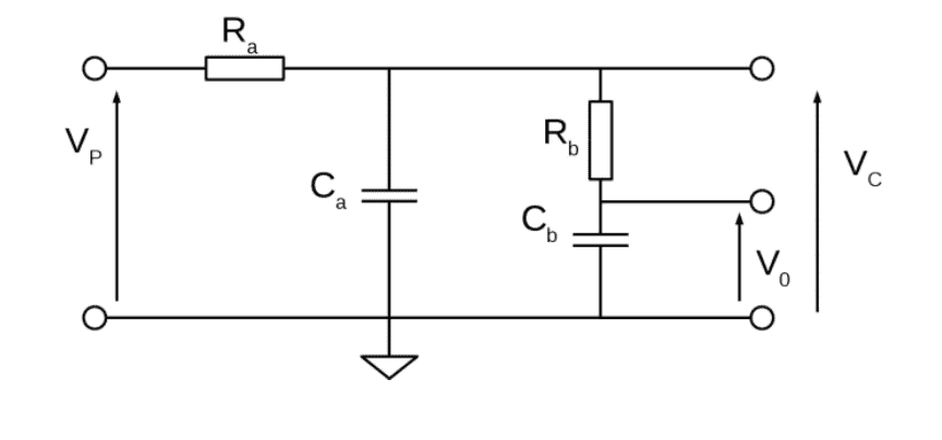

Hi,
I had one or two questions about the operation of a PLL, which refer to the diagrams below - a control representation of the system and a diagram of the low pass filter circuit.
Questions:
1) What is the point of having another (low-pass) filter ## G_f (s) ## for ## V_o ## after already passing the voltage through a low pass filter?
I know that we want to filter the pulses output from the phase detector to form a voltage to input into the VCO. However, why is there another filter ## G_f (s) ## that acts before the output ## V_o##?
2) Is there any particular relationship between the bandwidth of the low pass filter and the locking range of the PLL?
I think I am slightly confused as to what these terms mean. Is the locking range the frequency range over which the PLL works (i.e. can detect signal frequencies between ## x ## and ## y ##)? The bandwidth of the low pass filter determines the speed of response of the PLL?

I don't understand either. The PLL function ends at Vc, the frequency feedback. After all, you could disconnect Vo from Vc and you'd still have a perfectly functional PLL. You'll have to find the person that drew that block diagram and ask them. There are lots of reasons you may want to filter signals in a system, but you need to know about the system requirements to discuss those design aspects.

The capture range is the range of input frequencies that the PLL can sync with starting from the un-locked state.
The locking range is the range of input frequencies the loop can follow (stay locked to) after it has acquired lock within it's capture range. Of course, the locking range is always at least as large as the capture range.
The question about the effect of the loop filters is hard to answer. In general, that filter determines almost everything about how the loop works. So, yes, capture, lock, speed, all of it depends on the loop gain. Normally the phase detector and VCO are assumed to not really have any frequency dependence beyond the fundamental stuff they have to have, like phase being the integral of frequency.
edit: On second thought, the loop filter bandwidth is often irrelevant in determining the lock range, that usually has more to do with the VCO and phase detector or integrator ranges. The assumption is that the frequency is changed slowly when determining the locking range.
Yes, I will try to find who has created that diagram.
Okay that makes more sense.
Is the reason for the final filter because the PLL can generate frequencies that are multiples (harmonics) of the input frequency? Just asking.

Maybe, but recall that the output in this case is the lower frequency (filtered) PD output/VCO input. The "baseband" not the "carrier". So, much of that filtering can be done in the loop filter. Still there may be filtering requirements that they don't want messing up their PLL feedback loop. For example many HF receivers offer FM in both "wide" and "narrow" modes. This is undoubtedly filtering after the PLL that tracks/demodulates the carrier. More related to downstream functions like AGC or audio output.
Anyway, it's not a generalized thing. It all depends on what sort of machine these guys want.
What they are calling the phase detector has only one input. Seems foreign to me.
Yes, the summer, integrator, and phase detector are all part of the same thing. But I do like that they explicitly show the integration function in the loop. That's the part that many don't understand.
There are different types of phase detectors, but the xor gate is one of the most common. It is a 1 bit summer, so these diagrams are often drawn this way. Maybe because it looks like conventional feedback systems?
