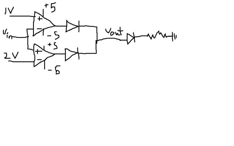

Ok, so I looked into that. So i decided to draw this out. Does my drawing appear to be correct.

Thinking about the 50mA limit, would I need to add a resistor after each opamp in front of each diode. Seeing that the PS is +-5V, so using V=IR, R=V/I=5/.05=100 ohms
So would using a 100 ohm resistor in front of each diode work. Then the two branches meet up and go to the led.

The word "work" can carry a number of connotations. :smile:
If you are designing for a target current through the LED, then you need to take into account the voltage drops across the diodes and LED. Does your LED even need 50mA?
"The circuit cannot draw more than 50mA" might mean that the op-amps plus the indicator LED in total must not exceed 50mA draw. So best to design for a small but adequate LED current, and check the data sheets for your dual comparator chip to see what it will draw. Some op-amps or comparators will draw less current than others.
What you have looks promising. You have one power supply, so where are you going to obtain the 2v and 1v? Your diodes form an OR gate and isolate the output of one comparator from the other.

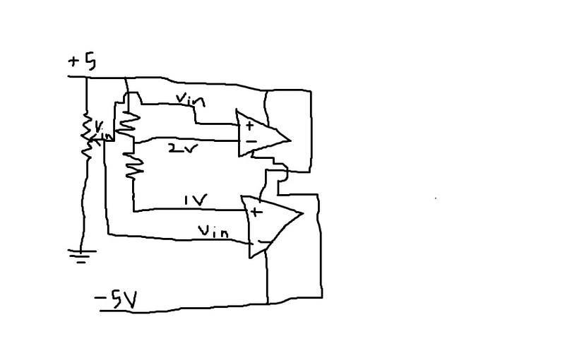

Alright, so would I need to have feedback for each comparator in order to get the 1v and the 2v?
Oh ok. So would I split the output from the 5V power supply into three branches:
one going directly to the opamp, another going through a resistor of X ohms then providing 2v, and a third going through a resistor of Y ohms then providing 1v.
Each potential divider involves a pair of resistors, not a single resistor.
To demonstrate a working circuit, you'll probably use a variable resistor across the 0..+5 rails to obtain an input that can be swung over 0 to 5v to test you have the correct triggering levels of your comparators. Is this what you meant as going directly to the op-amp?
I'm still not sure that you understand the op-amps require power to run them, quite separate to their signal inputs, even though this is not shown on normal circuit diagrams.
Ok, so would the beginning of the circuit look like the picture I have attached?
Thanks a lot for your help, you I realized that after I drew that picture, but we set it up in the lab and i got it working. Thanks a lot once again.
