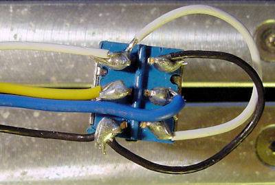

is this the way to fix the wires on the switch

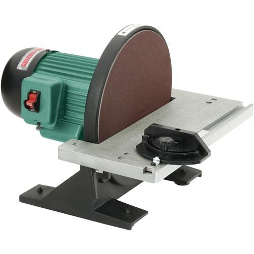

this is what i like to do .but 6 inch and reversable
You need to look at the wiring diagram for the motor and isolate the differences between CW and CCW. From there it should be reasonably easy to come up with switch wiring. IF the motor wiring is how I think it is then the back side of the switch you show in your attachment is probably right IF the terminals on the switch are how I think they are. It is not a matter of simply reversing the power leads. It involves changing the start winding leads relative to the run winding leads.

reversing wires T5 and T8 will reverse the motor,
but it is not clear to me from that drawing exactly what terminals you will need. Maybe ring lugs, maybe push-on blades...

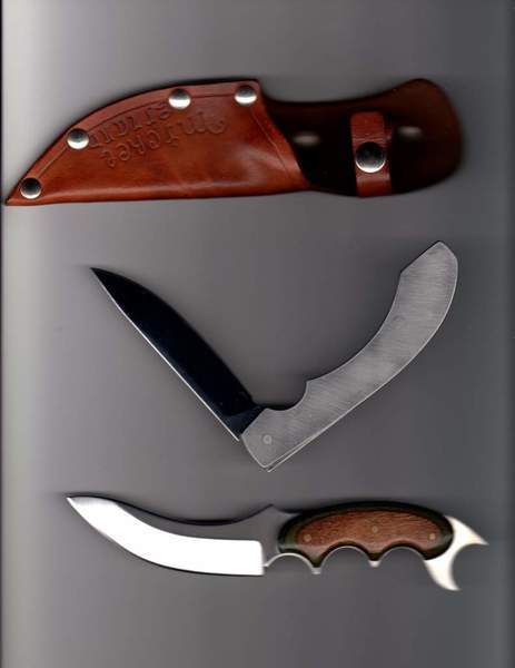

here is a few knifes pictures that i have left here .
all my blades knifes are mirror polishe .and i do all my knifes cases .
a knife cust me about 55.00 material and i sell them 125.00 .
so there is not much money here .it take 5 hrs from the start to finish .complite ready to go
