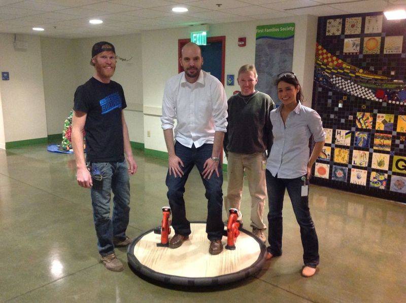

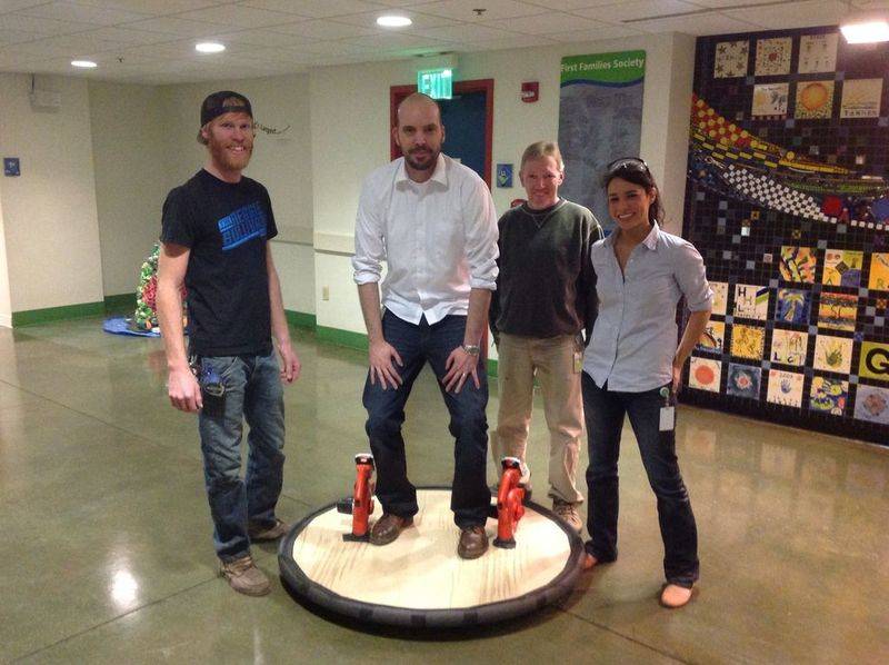

  • #49
bob012345 said:
3) What I want to make is a hoverboard or a device that gives as true a hoverboard experience of floating on air as possible for the fun of it. You stand on it and float above the ground. It's not meant to go more than 5-10 mph. It could be foot powered as to forward motion.
https://cdn.instructables.com/FOA/NTGC/HQKYBW2H/FOANTGCHQKYBW2H.LARGE.jpg
