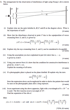

To be clear it's part (vi) that's unclear to me.
In order to ignore the cosine term it has to reduce to 1. This can happen, only if k(x1+x2)/2 = ωt
Is this a correct assumption ?
Also, it is known that k = 2∏/λ and ω=2∏/T
However, I'm trying to think in what way these two components could be equal but I can't get it.
Could someone give me some help, please ?
For a long exposure, you average y^2 over time - the constant phase in the cosine does not matter for the average.

A photograph collects light over a period of time.
The lightness in the photo depends on the intensity of the incoming light and the time of the exposure.
He's telling you to find y^2, then average it over time.
This gives you a function of position alone - which will be what the photograph shows.
When you do this - the terms you are worried about will cancel out.
Do you know what y=?
Do you know how to square a function?
Do you know how to average a function?

I can do the first two but not the last one. How do I average a function over time ?
EDIT: Why do I need to find y^2 ? Is it because intensity is directly proportional to Amplitude^2 ?
Did you read the links? The second one tells how to handle the average of a periodic function - what does it say to do?
I've carried out the steps for the time average for cos2x for limits 0 to T.
I've gotten : \frac{1}{T}[\frac{1}{2}T+\frac{1}{4}sin2T]
What do I choose to be T in this case ? Infinity ?
But it is not exactly cos2x that you have to average is it? x(t)=?
The trick with time averaging square trig-functions is to choose your interval carefully - if you let T be any integer number of quarter cycles, the average will make sense easily. I usually pick a singe period for T.
