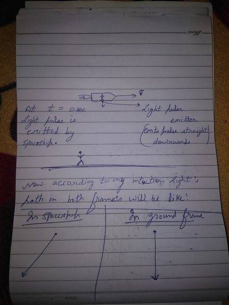

I'm sorry for not explaining my doubt clearly... I was in a kind of a hurry when I posted this.Well now, I have attached the situation which was in my mind then. The problem is what my intuition says in the image seems to be opposite to the real scenario, but I don't know WHY.
I hope now I'm clear in what my 'doubt' or 'Question' Is.
PS. Sorry for bad handwriting

Your situation is not very well defined because you have not stated in which frame the pulse is emitted straight down. If the pulse is emitted straight down in the ground frame, then indeed it will go somewhat in the "back" direction in the ship's frame. If it is emitted straight down in the ship's frame, it will go somewhat in the forward direction in the ground frame. This is called aberration of light.
This is actually what I'm not understanding .Why it should go in forward direction,it is not obvious to me as is to some of my peers.
Because, assuming that it is emitted straight down in the ship's frame, it will always be directly below the ship in the ship's frame. Since the relative velocity between the ship and the ground is orthogonal to this displacement, it always needs to be directly below the ship in the ground frame as well, which means that it needs to have a velocity component ##v## in the direction of the ship's motion in the ground frame.
This is not particular to light. The same would happen if you would drop a ball from the ship. The ball will then have a velocity in the ship's direction in the ground frame.

Yes...I understood your argument. You are saying that since light needs to be below ship in ship's frame so should it be in the ground frame by which you are giving rise to that velocity in the positive direction.Am I right.
But can one in ground frame tell why should that pulse have that forward velocity like the way we can tell in case of the ball?
In case of the ball, it is obvious since every particle of that ball has that forward velocity because of motion along the ship, but the situation with light seems different than that which I'm not understanding.
It is no different at all. You could also emit the light so that it goes straight down in the ground frame, but then it will not go straight down in the ship's frame. It is a question of how you emit the light. You cannot have it going straight down in both frames.

If you analyse the emitter in the moving frame you'll also see that it should emit at an angle.
For example, a laser is basically a light clock with a lasing medium between the mirrors. In the rest frame it's light pulses bouncing "straight up and down" that go back and forth between the mirrors, repeatedly passing through the lasing medium and building up stimulated radiation. In the moving frame, the lasing medium and mirrors would move through "straight up and down" light and the amplification effect wouldn't happen. It's the "diagonal" bouncing light that repeatedly passes through the medium and produces the laser. So the beam comes out diagonally.
I think this is what I was looking for. Can you tell where I can study this thing in some detail?
