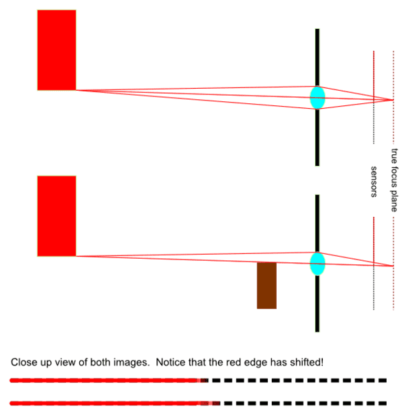

Draw a diagram tracing the rays of the edge going to either side of a lensed aperture and then converging again to a near focus. Do the same with one side of the aperture masked off. Look at the difference in the "circles of confusion" on the picture plane. If you interpret the densest image as being the actual edge, what happens to the image?
The circle of confusion is off center. So, its center is now shifted over. Thus, the actual object appears shifted. (Remember the picture plane is inverted.)

Here is a drawing as described in my earlier explanation:
Blocking off part of the aperture makes the edge of the object appear to shift. Here, the red block is the "medium" object and you are focused at "far".

Oh, now I understand it all, that drawing helped a lot! Thank you very much, all of you :smile:
I was searching for this explanation for long time :biggrin:
