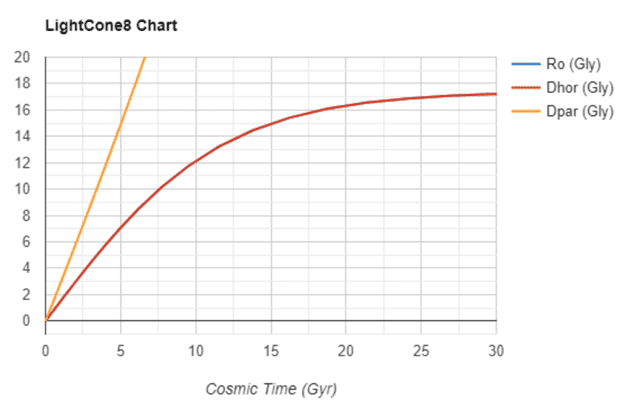

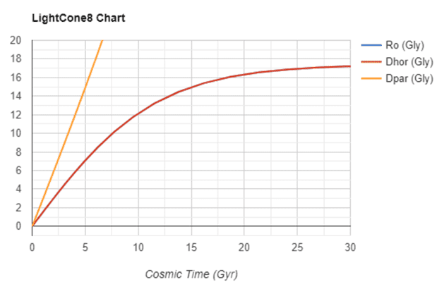

What is the status of LightCone8 Cosmological Calculator (v8.3.x) at http://jorrie.epizy.com/docs/? It still gives incorrect Dhor (Ro and Dhor overlap):
Please see Post #69.
  • #101
Jorrie said:
It may just be a cashed issue, . . .
You are right. It works for me too.
