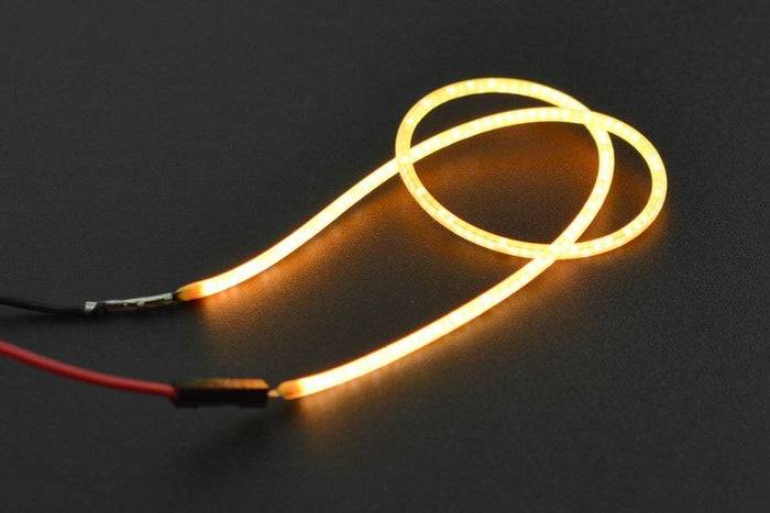

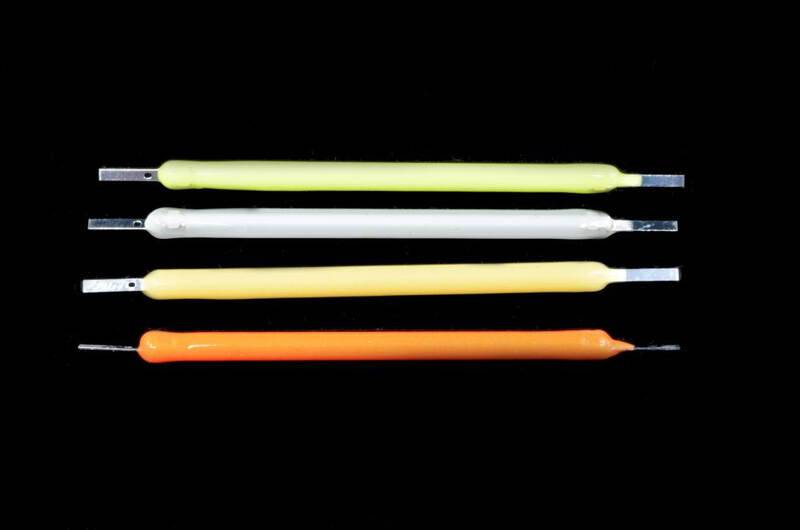

But if DIY is required, then I would check up on LED 'filaments': they are meant to replace incandescent lamps, with plenty of 'warmth' variations...
Also, without that disturbing 'pointiness' of regular LEDs.
https://www.physicsforums.com/attachments/s330529193385665136_p196_i4_w997-jpg.318754/
Ps.: there are flexible ones too, these days...
