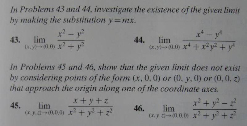

See the first photo.Q45
Can I use the method similar to 43?
I don't understand what does "condering (x,0,0)or (0,y,0) mean.

For a limit to exist, you can't get different answers depending on the direction you approach a point. When the problem says to consider points of the form (x,0,0), it's asking you to calculate the limit as you approach the origin along the x-axis.
BTW: What do you conclude about #43?
For 45 try this
[tex]f(x,y,z) = \frac{x + y + z}{x^2 + y^2 + z^2}[/tex]
What happens when you cut with x = x and with y,z =0? What happens to f?

It becomes [itex]\frac{1}{x}[/itex]
Then, as x[itex]\rightarrow[/itex]0, [itex]f(x,y,z)[/itex] doesn't exist?
