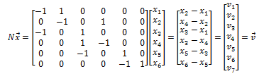

I don't think the problem is with the linear algebra. Your problem seems to be in deriving the correct equations that correspond to this circuit. The fact that you can change the circuit and yet not change the equations should be a giant red flag to you that your method is wrong.
Look at what you wrote here:
How can it possibly be correct? You have a six-component vector set equal to a seven-component vector.
Can you define for us what the x's and y's stand for? From a dimensional analysis point of view, something is amiss. It looks like the y's are voltages, yet you're multiplying them by R and getting currents. That is, your version of Ohm's law is I=VR.
  • #34
Yea your right about that. Thanks for catching that. It's a typo. It's supposed to be:
That does seem to be problematic. But I'm not exactly sure what would change in the equations. The incidence matrix N and six columns and six rows. The first column represents node 1, the second column represents node 2, and so forth. Row 1 represents edge 1, row 2 represents edge 2, and so forth. I populate the incidence matrix N by looking at each edge and if crrent is leaving the node I put a negative one, and if it's entering the node I put a positive one.
The vector V is the voltage across each resistor. At least this is how I was taught but to me it looks like the opposite of the voltage drop. Like I have the following
X_2 - X_1 = V_1 when in my opinion X_1 - X_2 = V_1. But this is how we were taught, not sure if it's wrong?
The resistance matrix R is just a diagonal matrix, where column one row one represents R_1, column 2 row 2 represents R_2 and so forth.
HW solutions solved a similar problem in a similar way but the final calculation was never done. My textbook doesn't seem to have a resistive circuit example.

I try re-entering this into MATLAB and create the zero matrix A to help.
>> N=[-1 1 0 0 0 0;0 -1 0 1 0 0;-1 0 1 0 0 0;0 0 1 -1 0 0;0 0 -1 0 1 0;0 0 0 0 -1 1]

  • #35
YoshiMoshi said:
The incidence matrix N remains the same. Right?
Isn't that thing that uses the
symbol a node that should be included? After all, it's purpose is to carry current.

Yeah I'm using MATLAB to performing the matrix calculation. I think that the problem is defiantly this
inv([R N;N' A])
MATLAB is telling me that the matrix is singular. I defiantly think that R is ok. So N must be wrong, but I don't necessairly see how.
I see possibly that node 6 is connected to ground, which also connected to a two ampere power source which is connected to node 4. Do I need to include this in my incidence matrix? Do I have to call the current source an edge 7 and extend my R matrix to have the seventh row and seventh column be 0 since an ideal current source has zero resistance. Like I'm wondering if I need to update the matrix N to a 7 x 6 matrix were current is leaving node 6 and entering node 4?
Let me know if you don't know what I'm talking about.
I don't think it works. I just tried, N would be a 7x6 matrix, R would be a 7x7 matrix, N' would be a 6x7 matrix, and the zero matrix would be 7x7. MATLAB wouldn't allow an inverse matrix on such a matrix.

YoshiMoshi said:
I thought i did though in number 34? What other changes do I still need to make exactly? Sorry I'm not sure.
I'm not sure either as the method of circuit analysis that you're using is not one I use. But I did note that I don't see where the 2 A current source fits in with your incidence matrix. Shouldn't it have an "edge"? It moves current from node 6 to node 4.
  • #49
Ya I normally don't do it this way either. But yah I put it in matrix I.
I believe my solution is correct in #34 it's just giving me the error because the determinant of the matrix is nearly zero, so when MATLAB takes the inverse of the matrix it throws an error saying that it's signular or nearly singular and that the calculation may be incorrect, which the answer MATLAB provided doesn't match with my simulated answer.
That's why I put it in the MATH section because I think I'm more strugling with the linear algebra method of solving this problem and not so much the engineering aspects of it, but it got moved here.
I think this is now a linear algebra problem and think that MATLAB is giving the wrong answer because it's nearlly singular. I'm almost positive because that's what MATLAB says and sure enough the determinant is nearly zero, and when the determinant is zero the matrix cannot be inverted. I can still invert it though because it's not exactly zero but close to it. So I'm just wondering what I can change so that this is no longer the case. But a 12x12 matrix is kind of hard to work with and I'm not exactly sure which numbers should get changed.
