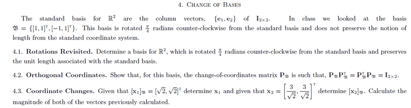

I'm working on the problems attached.
I think I understand how to do problem 4.3 but I'm lost on 4.1 and 4.2, and I'm pretty sure i need to figure those out before I can do 4.3.
Can someone please try to guide me through 4.1 and 4.2? Thank you

For 4.1:
So your rotation matrix doesn't preserve the length of vectors. What does it do instead? If you don't know, run some vectors through your matrix (that is, multiply the matrix by the vectors). Can you think of a way to rectify this so you have a matrix that does preserve the length of vectors? (Hint: rotate some vectors yourself and see what their coordinates change to)
For 4.2:
So now consider the matrix from 4.1. If you had a vector in R2 and you wanted to know what that vector would be in the new basis, what would you do? How could you use the matrix in 4.1 to find it? That would be your change of coordinate basis. Then prove those things about it.
I'm going to focus on 4.1 first. The rotation matrix length goes from sqrt 2 to 1. I'm not sure how to make it so that the length is preserved.
Try multiplying the rotation matrix by some positive constant and see what happens.
wait, which matrix is the rotation matrix? I probably sound really stupid but I'm completely lost

4.1 is concerned with a little problem with these two bases. Often we would like to have it so that if a vector has a certain length in one basis, it has the same length in another basis. So above, our vector has length 2 in the standard basis, but length [itex]\sqrt{2}[/itex] in the basis B.
So you are supposed to find a different basis (also confusingly called B) made up of two vectors such that we preserve the rotational aspect, but now if a vector has length M in the standard basis, it should also have length M in the new B basis. We can get to matrices in a minute.
If you're not sure what to do, convert a few vectors from the standard basis to the old B basis and look at their lengths in each basis. A pattern should become clear.

That's right. The length in the standard basis is [itex]\sqrt{2}[/itex] times the length in B.
So how could you modify the vectors in B so that the ratio is 1:1? (Hint: try scaling them by constants to see what happens.)
If i take the basis B and multiply each component by 1/sqrt(2) I think that makes the lengths come out the same
So, for 4.1 the B would be changed to what i said above. That was more simple than I expected it to be. But it makes sense. Thank you
For 4.2 the matrix P_B would be {[1/sqrt(2) 1/sqrt(2)]^T, [-1/sqrt(2) 1/sqrt(2)]^T} correct? So would I just make that into one matrix and perform the operations on it?

I tried it by hand and got the property to work out to the I matrix both ways
Also, for 4.3 I got x_1 = [0 1]^T and x_2 = [0 3]^T
If you get a chance could you please check if those are correct? Thank you
OK, the first one can't be right at first glance, because the magnitude of x1 in B is 2, but the magnitude of [0 1] is 1.
For the second one, they gave you the representation in the E basis (both elements are positive) and asked for the B basis. Now your vector [0 3] says that our vector is 3b2. But the first component of b2 is negative. So 3b2 also has a negative first component.

Oh ok, so x1 would be [0,2]^T
but I'm still confused about x2. I did it that way and still got the same answer. I don't really understand what you said about the 2nd one in post 14
For x2, they are giving you the vector in the standard basis and asking for its representation in the B basis. So you have to do the transformation backwards.
Oh! I don't know how I missed that, I read the problem so many times. Sorry. So the vector would actually be [3 0]^T
