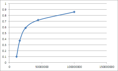

The resistance for a wire with cross-sectional radius r is given by R = k/(r^2). Convert this equation to a straight line for which k can be determined from the slope.

I'm not sure how to linearize this equation, this is where I get stuck. ln(R) would represent y on the graph. k ought to equal the slope, but I can't see how to do that.
What you have done is a perfectly good analysis but k is given by the intercept (lnk) on the graph.
The slope of the ln-ln graph is -2. This is the value of ln-ln graphs...enables you to determine the power law of a set of data.
Since R =k/r^2 a graph of R against 1/(r^2) will be a straight line with gradient k
The problem is that if I plot given values of R on the y-axis = R and given values of r on the x-axis = (1/(r^2)), my graph looks like this:
Edit: This is my dataset

Why not plot a graph of R against 1/r2?
That should give a straight line y=kx which should pass through the origin as when r = 0, so should R. The c would be zero.
It is handy to get used to the idea of choosing what to plot against what in order to get a straight line graph. I remember needing quite a few examples before it became 'obvious' what to do.
That graph I showed is R against 1/(r^2). My problem is that it is very curved, so I don't have a best-fit line.
If I use some known value of k to produce my own table of r and R from R = k/(r^2), I do get a linear fit, so I guess I'm missing something involving the dataset.
Sorry. I was being dumb. You are right. The graph looks so wrong that I assumed you'd not actually plotted it right. But the values certainly give that odd curve.
I think the data must be wrong - unless it relates to something that can get hot for thin samples and not following Ohms Law. You'll have to ask your tutor, I think.
