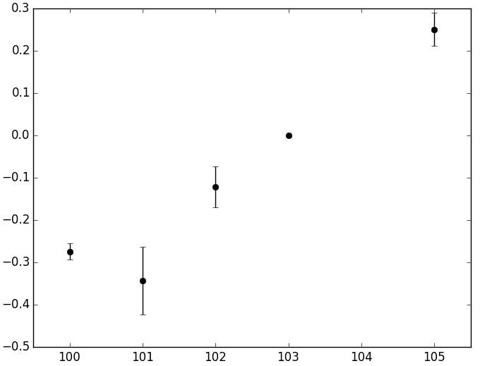

@Stephen Tashi , @Dale here is the problem that I am trying to solve (although the specific problem is not that important, I am more interested in a general approach). I want to calculate the isotope shift for a given element i.e. how much the radius of the nucleus of a certain element changes for different isotopes, relative to one of the isotopes. I attached a plot of one of these examples (in this case it is the 4th point that is the reference one). I need to fit a straight line to this (in order to do some further calculations using the parameters of this line) and as I said, I am mainly not sure how to handle the fact that the 4th point has zero error. @Dale I am not sure what you mean by using a constant. Why would I have an error on the 4th point (in this case), if I know for sure that the isotope shift of that point, by definition, is zero?
Because the best fit line may not go through the 4th point. So forcing it to do so is a bad idea.

So you are saying that for the 4th point I should just attach the original error i.e. ##dy_1## while for the other I should still do what I am already doing i.e. ##\sqrt{dy_1^2+dy_i^2}##? I see what you mean, but I am still not totally convinced. The fact that I have that infinity is clearly not ideal, but why wouldn't I want my fit to go thorough that point? Intuitively, a fit should reflect the data as well as possible, so if I am confident that the isotope shift for that point is exactly zero don't I want my fit to go through that point? In general you want your fit to be as close as possible to the points you are confident about. I guess what confuses me is, what is the meaning of an error term associated to that 4th point? I am 100% confident that subtracting that radius value (whatever that is) from itself, should give me zero. It's like measuring the speed of an accelerating car versus time. You might have some error in measuring the velocity, but when the car starts, that's your definition of zero and you want a fit to your data to reflect that the velocity at ##t=0## is zero, because that is the point you are the most confident about.
As I mentioned in my previous post, if you are doing weighted least squares regression you need to employ the covariance matrix if the errors are correlated. If you do a weighted least squares fit to the ##(x_i,\Delta y_i)## data , the errors are correlated. Hence it insuficient to consider only the errors whose standard deviations you denote by ##\sqrt{ dy^2_1 + dy^2_i}##.
In a weighted least squares curve fit, the only way to incorporate the information that ##\Delta y_1## is always 0 is not to fit a curve of the form ##\Delta y = Ax + B## to 5 data points. Instead you must fit the curve ##\Delta y = A(x - x_1) + \Delta y_1## to the 4 data points left after excluding ##(x_1, \Delta y_1)##.
You should consider doing a linear regression to the ##(x_i, y_i)## data then using the slope of that line to estimate the
curve that fits the ##(x_i, \Delta y_i)## data. I can imagine reasons for not considering that. Suppose the experiment has an uncontrolled aspect that can add the same random constant into each ##y_i## measurement, then to make a prediction that useful in a repetition of the experiment, it would be natural to measure departures in ##\Delta y## from some reference value ##\Delta y_1##.

I am not sure I understand why are the errors correlated? Each point ##y_i## is measured independently.
But the points ##\Delta y_i## are not measured independently.

What do you mean? ##\Delta y_i = y_4 - y_i## (in the isotope shift case), so if ##y_i## and ##y_j## are independent, why subtracting a constant value (in this case ##y_4##, which is a constant in the sense that it has the save value for all ##\Delta y_i##) would make them not independent anymore. Is the degree of correlation between 2 variables changing by adding a constant term to both of them?
if yi and yj are independent, why subtracting a constant value (in this case y4, which is a constant in the sense that it has the save value for all Δyi) would make them not independent anymore.
Assume the linear model for the ##(x,y)## data is:
##y_i = A X_i + B + e_i ##
where ##y_i## is the measured value of the actual value ##Y_i = AX_i + B## and ##e_i## is a random error with mean zero. Assume ##e_i,\ e_j## are independent random variables for ##i \ne j##.
The linear model for the ##(x,\Delta y)## data is:
##\Delta y_k = (y_1 - y_k) = ( AX_1 + B + e_1) - (AX_k + B + e_k)##
## = A(X_1 - X_k) + (e_1 - e_k)##
The errors in ##\Delta y_j## and ##\Delta y_k##, each contain the term ##e_1##.

Imagine 100 different experiments where the ##(x_i,y_i)## data is taken. If we picked the value ##y_4## from the first experiment (or picked an arbitrary value for ##y_4##) and always used it to compute ##\Delta y_j = (y_4 - y_j)## on subsequent experiments, then we would call that subtracting a constant from the data. However, if ##y_4## includes the result of a possibly random measurement error and we use a possibly different value of ##y_4## to compute ##(y4 - y_j)## on subsequent experiments then ##y_4## is a random variable, not a constant.
Considering ##y_4## as a random variable, is it surprising that the random quantities, ##y_4 - y_2## and ##y_4 - y_3## show some dependence?
If you don't want to think about repeated experiments, then the concepts of "independent" and "dependent" have no meaning because they refer to properties of random variables. Likewise the things you denote by ##dy_4## and ##dy_3## have no meaning as properties of random variables unless we are permitted to imagine repeated measurements of ##y_4## and ##y_3##.
