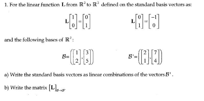

Does anyone know what L is? I'm trying to see if I could find videos on it on YouTube.
On the first question this is what I think- [a;b] is a vector by the way:
1) [2;1]c1+[7;4]c2=[1;0]
[2;1]c1+[7;4]c2=[0;1]
I could have also combined those two by having the linear combination equal to a size 2 identity matrix, right?! Is this correct?
2) This is where I'm lost. I know how to switch between a standard basis and a given basis. I'm not exactly sure of the nature of the equation being asked or what it even is, including what L is.
  • Problem statement: linear function L from R^2 to R^2 with L of (1,0) equal to (0,1) and L of (0,1) equal to (-1,0); bases B = {(1,2), (3,5)} and B' = {(2,1), (7,4)}; parts a) and b) ask for standard basis vectors as combinations of B' and for the matrix [L] from B to B'.

Let me take a guess at L. From the first condition, it takes an x and transforms to a y. And from the second condition, it takes a y and transforms to a -x.
L = \begin{bmatrix}
0 & -1 \\
1 & 0 \\
\end{bmatrix}
you can check that this L satisfies your mapping constraints.
What do you mean? The problem statement tells you what L is. It's a linear function between R2 and R2.
Strictly speaking, what you wrote has no solution because there are no ##c_1## and ##c_2## that satisfy both equation at once. Assuming you're just being sloppy, I'd say you have the right idea.
Not really. How can a linear combination of column vectors produce a 2x2 matrix?
What do you mean when you say you "know how to switch between a standard basis and a given basis"?
