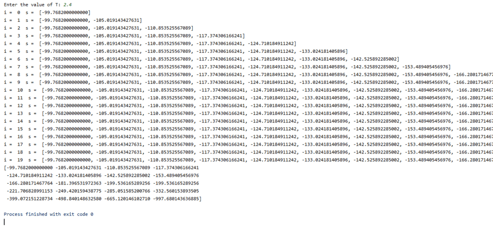

I found during debugging that in line no. 29, if I change np.size(vol) to anything <= 20, I get a good output:
(Couldn't give the full output screen, but the fact that it finished with exit code 0 means that there was no error.)

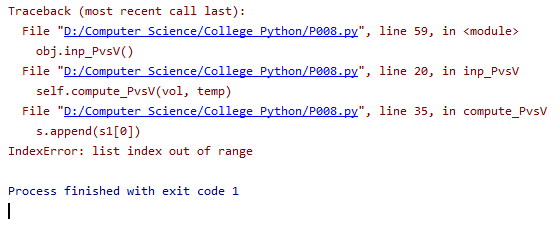

When I change the number to anything > 20, I get an error:
This seems more like an overflow problem. My code is unchanged, only that number in the range increases, and I get an error. But I am supposed to accomplish this task for 2001 values.

Note that the error is in the line that says, "s.append(s1[0])". This means that the line above which is, "s1 = solve(eq, p)" didn't return any solution. You should add a print statement above the failing line to print out s1 and the values of the equation you are trying to solve to see whay there is no solution.
Yes, you are right. s1 is empty when i=21. I will have to see how to solve that problem.
Line 17 might have something to do with it. :wink:
Yeah, I know that. Actually there is a problem when ##v=b##, where the lhs-rhs becomes 0. I shifted that to the front by changing ##b## to 1.0, and then excluded ##v=1.0## case. With a little bit of extra effort, this can be resolved for any ##b=v## case.
