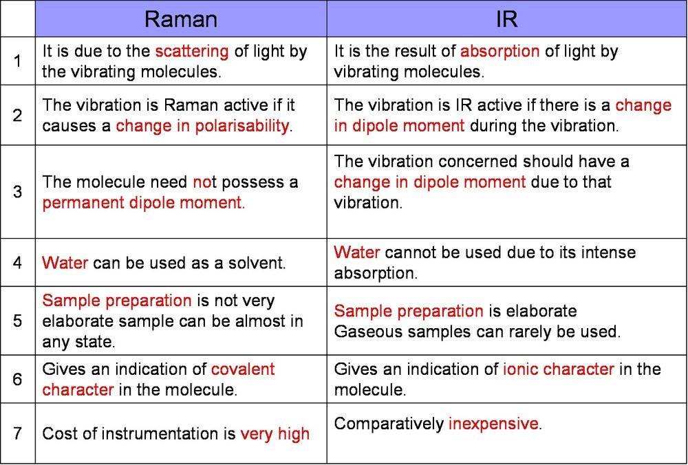

There is a lot that is wrong in there. You should really pick up a chemistry textbook or dig into Openstax as @jedishrfu suggested.
All molecules absorb and emit IR radiation, whether polar or not. It is related to the vibration of molecules, i.e., the relative motion of the nuclei with respect to one another.
The only IR spectrometer I know of are laboratory equipment, and I don't think that you would be able to use one (or even prepare samples to be studied) without some guidance.
Not quite all. A molecule needs transition dipole moment around a bond, any bond.
Diatomic molecules with same atoms both side of bond cannot absorb or emit IR. Such as N2, O2 or I2.
Diatomic molecules with two different atoms can have quite small dipole moment, but the dipole moment would have to be exactly zero to prevent IR. CO has only a small dipole moment, but does absorb IR.
Now, many molecules have several slightly polar bonds whose dipole moments cancel out by symmetry. In CO2, the two C-O bonds are opposite in direction so dipole moments cancel and carbon dioxide is not polar. But the IR absorptions do not cancel, which is why CO2 is a greenhouse gas. In CH4, C-H bonds have little polarity - carbon and hydrogen are close but not exactly equal in electronegativity - and the 4 dipole moments cancel out anyway. But the IR do not cancel, and weak as the polarity is, it is enough to make methane a greenhouse gas.
To put alkane polarity into contect, while ethane also has no dipole moment due to symmetry, propane does not have such symmetry. Two hydrogens are on one side of central carbon, two methyl groups on the opposite side. Resulting in a nonzero dipole moment... of about 0,1 D. Compare dimethyl ether with the same bent geometry but two O-C bonds... dipole moment 1,3 D.
Oh, and NO, not all polar molecules are electrolytes. Dimethyl ether, acetone... fairly polar but not enough for electrolytic dissociation.

Yes, homonuclear diatomic molecules are an exception, but I didn't want do get into those weeds.
By the way, what is important is not the dipole moment, but the variation of the dipole moment as the molecule vibrates.

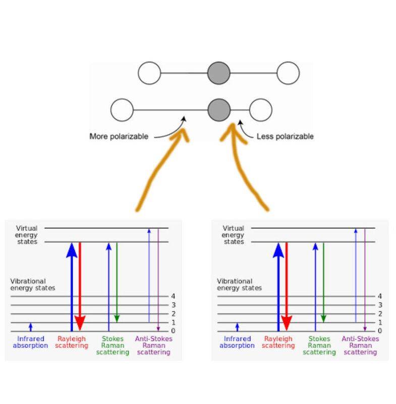

I think the simple rule is simply. IR spectroscopy spectrum (low infrared) come from interaction within a single molecule. While thermal IR (mid to far infrared) comes from interaction *between* molecules. Right? So in the case of thermal, all molecules produce IR unless at vacuum.
No.
Do you mean "absolute zero" instead of "vacuum"?

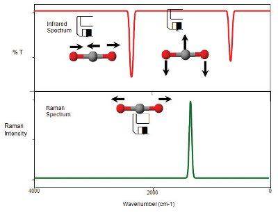

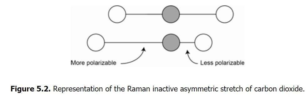

jake jot said:
This is related to my reply to @snorkack. The normal modes of CO2 that are active in the infrared are the asymmetric stretch and the bending modes, which change the dipole moment of the molecule (in this case, induce a dipole since CO2 is globally non-polar), while the symmetric stretch is not active in the infrared (dipole stays unchanged, = 0) and is only observable in Raman spectroscopy.

Something I don't quite get even after googling. When molecules are asymmetric, the movement can cause dipole moments and infrared active, the explanation being it moves like antenna sending infrared photons. No problem about this.
But with regards to polarizability, which involves the formation of temporary dipoles due to momentary electron cloud distortions. How come polarizability is low in asymmetric molecules? Do they cancel? How? I heard about the rule of mutual exclusion. But I want visual explanation why polarizability is low in asymmetric molecules.
About number 6. So IR spectroscopy gives an indication of ionic character in the molecule. There is no exception to the rule where covalent character is indicated?
Do you have a source for this?
The point is that the dipole is an indication of an uneven distribution of electrons. Hence a less covalent bond.
Here is the exact passage:
Chapter5.pdf (uc.edu) (page 2)
"The mobility of electrons in a bond is called the Polarizability of the bond, i.e. a measure of how easy it is to move electrons and polarize a bond. For bonds with a strong dipole moment (which are IR active) the mobility or polarizability is
usually low.".
Do you think it's low or cancelled? In the following explanation, it's sort of cancelled.
5: Raman Spectroscopy - Chemistry LibreTexts
"The asymmetric stretch of carbon dioxide is IR active because there is a change in the net molecular dipole (Figure 5.2). In the asymmetric stretch, one bond is stretched and is now more polarizable while the other bond is compressed and is less polarizable. The change in polarizability of the longer bond is exactly offset by the change in the shorter bond such that the overall polarizability of the molecule does not change. Therefore, the asymmetric stretch is not Raman active.
I want to understand how exactly "The change in polarizability of the longer bond is exactly offset by the change in the shorter bond such that the overall polarizability of the molecule does not change.". Does it mean polarizability is also present but in the case of asymmetric molecules, it's cancelled? How is it canceled when the each side have separate electron cloud? How does the electron cloud in each side interact so that they are cancelled, and hence not Raman active?
