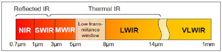

What I was inquiring in second to last message was about the equipartition of energy where the energy can be distributed in rotational, vibrational or electronic modes of vibrations.
Diagram of infrared wavelength bands from 0.7 µm to 1 mm: Reflected IR (NIR, SWIR) and Thermal IR (MWIR, low transmittance window at 5 µm to 8 µm, LWIR, VLWIR), with a break marking the 14 µm region.
The fundamental modes of molecular permanent dipole moments are in the range of 3 to 15 micron. Most IR spectrometers I saw are in the NIR range which is 0.78 to 2.5 micron. And these can only detect the overtones of the fundamental modes.
Chemistry: Notes about IR spectroscopy (openchemistryhelp.blogspot.com)
Energy level diagram with a vertical arrow labelled e; horizontal levels labelled v = 1 through v = 5 and v = ∞, with a red upward arrow from v = 1 to v = 2 labelled Fundamental and blue arrows to higher levels labelled overtones.
So in my question to you. I wasn't asking about polarizability anymore but how rotational, vibrational, electron degree of freedom in the equipartition of energy is related to the permanent dipole moments. You said not significant. So what wavelength are these rotational, vibrational electronic degree of freedom?
Also I was googling about "thermal imaging and dipole moments". I couldn't find any hits. Thermal imaging seems to involve blackbody radiation. But what molecular modes contribute to blackbody radiation? If you can see the wavelength range above. The thermal modes overlap with the permanent dipole moments modes.
I already owned a thermal imaging system that can probe 7.5 to 13micron wavelength. So I need to understand everything about the infrared wavelength to understand it all. I indeed tried to google and read a lot. So I'm not seeking a tutorial here but just clarifications. That's all. Thanks.

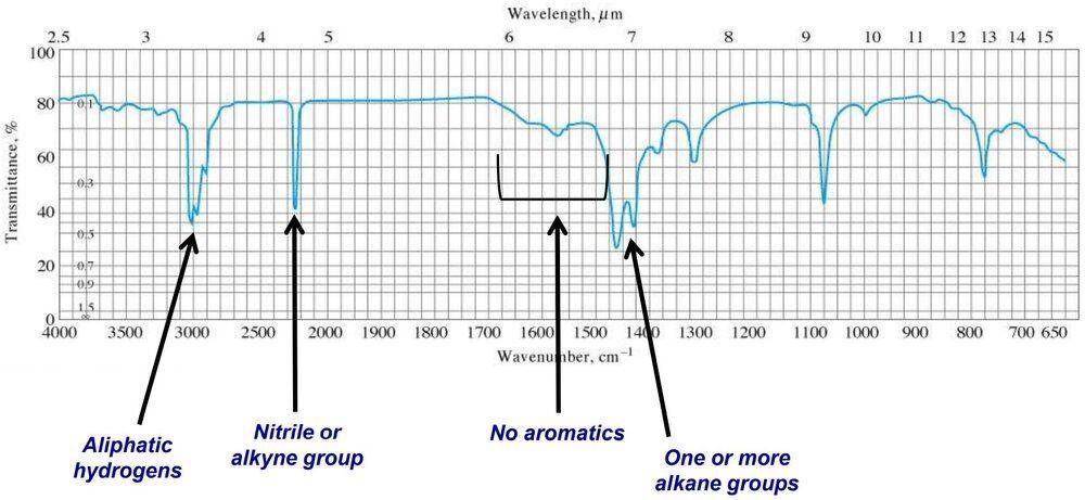

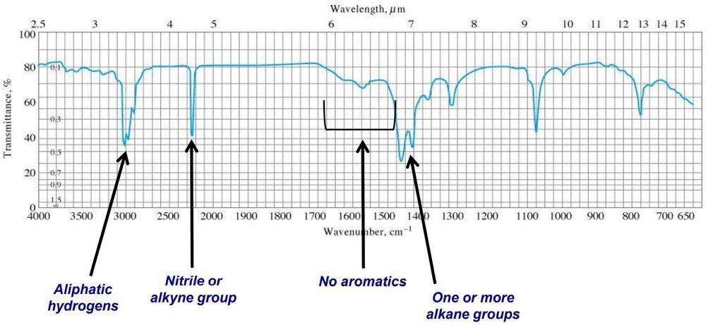

Ok thanks. But why do the wavelengths of dipole moments and thermal imaging coincide at 3 to `15 micron?
an example of IR spectrum
Annotated infrared spectrum plotting transmittance percent against wavenumber in cm-1 and wavelength in micrometres, with labelled peaks for aliphatic hydrogens, nitrile or alkyne group, no aromatics, and one or more alkane groups.
