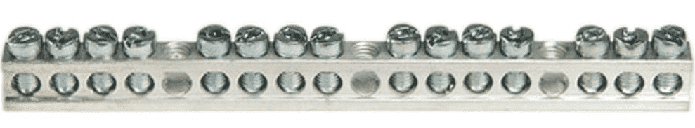

Are you talking about screws for ground bar(s) like the 15 terminal SqD part #PK15GTACP pictured below?
I've never seen screws for them sold separately, but that's not to say they aren't. If refurbishing a load center it is best to replace the bar(s) with new parts - the aluminum threads stretch a bit when tightened to spec torque - and salvage screws from the older bar.

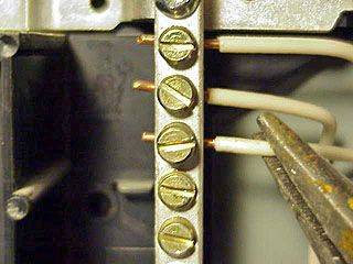

Are you stripping off enough insulation so that the wire goes completely through the connector?
image compliments of pinterest.com
Yes.
The picture suggests that the exposed tip of the bare wire shoud be used to position the wire directly under the end of the screw. I find that doing this doesn't prevent the end of the screw from pushing the wire to one side once it makes contact. Flattening the end of the wire would help, but I've never seen this recommended.
It might be better to relieve the face of the screw so it contacts at 2 points.
Don't these terminal strip come in 2 versions; one for stranded wire and one for solid wire? The solid wire version might have a pointed tip on the screw, but flat tips for stranded wires.
With multi-strand wire you might crimp on a bootlace ferrule before tightening the screw. That will protect the individual strands.
