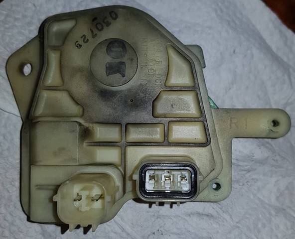

Photo of a removed automotive door lock actuator with a white plastic housing, a round label reading 030725, and two connectors on the lower edge, one with two pins and one with six pins; a mounting arm extends to the right.
I got this honda crv 2004 rear cargo lock actuator accidentally replaced when it was working.. although Honda said it might not be working. So I want to check if it is really working or not. Which of the 5 terminal can move the actuator by suppying with 12 volts DC supply?
I watched a lot of youtube videos, but they are mostly about replacing the actuator.. I want to test it isolated if the arm is still functioning or not.

If you can get to the connectors on the one they installed, back probe or disconnect each connector to see which pins have 12 volts when being actuated.
You need the part of the wiring diagram for that vehicle that shows this component. You can buy them at auto parts stores or your local Honda dealer, or you may be able to find the schematic by searching online.

I remembered I had no problems with the rear cargo lock. But the honda service representative heard me wrong.. I told him to replace my backseat right side.. he thought it was cargo rear.. and replaced the cargo lock. He told me it's not working anyway. So I just want to test if the lock actuator removed is really defective or not.
Many here are mechanical engineers. Maybe they have memorized the pin diagram of this lock actuator? Hope they can tell me which of the 2 powers it because I don't have any access to any wiring diagram.

I called up the honda parts and service department. They didn't know the pin assignments.. so I hooked up a 12 volts adapter and tried the terminals.. well.. the left socket with the two terminal is the one connected to the small motor. And it works.. so the Honda service fooled me by saying it's defective when it's not. I spent $60 for it.. so in order not to get into bad mood. I'll take the opportunity for me to be familiar how the whole system works.
