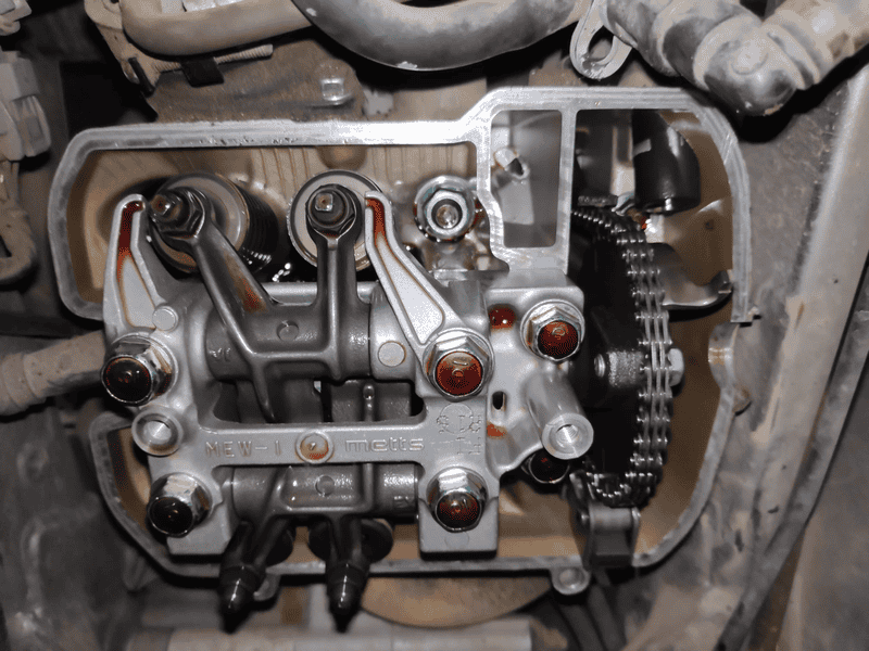

I have an old second-hand motorbike and I'd like to have it in as good condition as reasonably possible.
I bought a second-hand Honda NT700V Deauville with 62000 km. I did some basic maintenance (oil, oil filter, and air filter) after the purchase, and it worked more or less OK.
At 66000 km a bigger maintenance was due. It was discovered that the drive shaft was obliterated. It's a weird thing because these components are supposed to outlast the bike. We couldn't understand what could have happened. Anyways, 500€ later I had a second-hand drive shaft ready to be installed.
Now, after ~6000 km, I have discovered the mechanic didn't use the right lubricant for the drive shaft he installed. I guess this is how premature failure of the component happens so I'd like to fix it.
The mechanic has confirmed to me he's used lithium grease. However, the official service manual recommends MoS2.

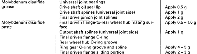

I'd like your help with a few things.
  1. Should I completely take the drive shaft apart to clean it off and reapply the right lubricant?
  2. Do you think applying a greater quantity than specified can be a problem? I might have trouble being that precise.
  3. Do you understand the difference between MoS2 grease and MoS2 paste? To me, it feels like the grease is more important because it's the part contacting the splines (moving parts) and where I believe the last mechanic used lithium grease.
  4. I am not a mechanic nor an English native speaker. Besides, the service manual I have does not show pictures of the components it's referring. If I end up taking apart the drive shaft and sharing pictures, would you know how to identify the shown parts?

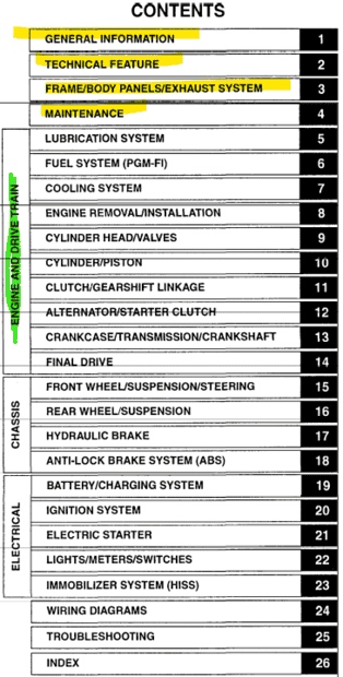

The service manual I could find covers the highlighted sections in yellow. The only thing mentioned about the lubrication of the drive shaft is what I shared in the OP.
Juanda said:
The details of the transmission are in the green section that I don't have.
My concern is that I don't want to ruin the drive shaft I already had installed because the lubrication work done on it was not correct. I have been running with the wrong lubrication for a little more than ~6000 km... I'm hoping this was not enough to cause some permanent significant damage.
Now I'm wondering what's the best approach to handle the problem which takes me to the 4 points made in the OP.

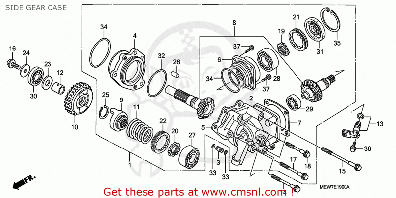

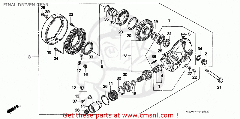

1) Yes. The molybdenum-disulfide should reach, and stick onto, the metal surfaces that work harder in your final drive, which are moving (or sliding) relatively slowly respect to each other, and simultaneously exerting a huge superficial pressure.
2) If moderate, no problem other than grease may leak out of the transmission case and reach the tire. 1 gram of grease is about 1.25 c.c.
3) Please, see:
https://en.wikipedia.org/wiki/Molybdenum_disulfide#Lubricant
https://mclube.com/products/industrial-lubricants/molybdenum-disulfide/moly-grease-and-moly-paste/#:~:text=Pastes form a thinner lubricating,parts under extreme load pressures.
4) Yes.
Please, see:
https://images.cmsnl.com/img/partsl...final-driven-gear_big00028984f__1600_6911.gif
https://images.cmsnl.com/img/partsl...nd-side-gear-case_big00028984e__1900_8af7.gif
You can also find many experienced mechanics and NC700V owners here, who will be happy to help you:

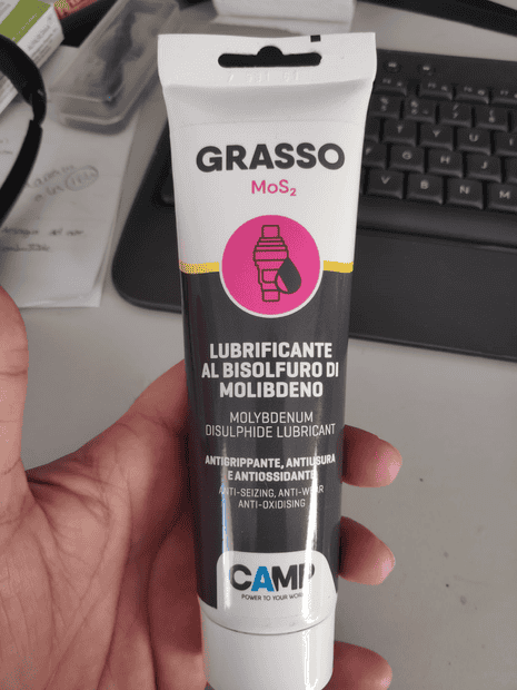

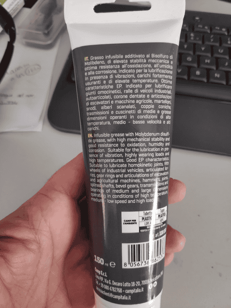

By the way, the only MoS2 grease I could find for the drive shaft is this one.
The container specifically mentions splines and it's made in Italy so I guess I can trust it. I was trying to find the % content of MoS2 because, according to HONDA it needs to be 40% MoS2 and 60% grease but nowhere on the internet I can find that info. (That percentage comes from a couple of videos on YouTube, I should check the actual manual now that I have it)
Is their formula secret or something like that? I tried looking for the specs, the datasheet, checking the product on many pages, etc. All I can find is the same description that's written in the bottle over and over again.
Do you think I'm worrying too much about it? I plan to use it soon but a second opinion would be a relief.

With a wink and a prayer?
How much do you value the motorcycle?
I suggest you call or email the grease manufacturer; ASK them about the MoS2 percentage without telleing them what your requirements are.
Here in the US, unavailable specifications make many of us suspicious as to the reason for the omission.
Keep the Shiny side UP!
Tom

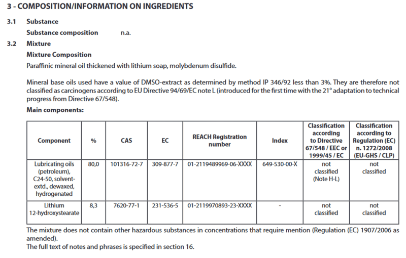

berkeman said:
I did a Google search on grasso mos2 msds and got a lot of hits (although not for that specific manufacturer, I think).
Here is a table out of the first hit on the list:
https://www.myoleo-mac.com/media/fi...2c-b9409c8628ba/07_om_grasso_mos2_rev2_gb.pdf
I checked the page and strangely enough, the MoS2 doesn't appear on the table. Percentages don't add up to 100% so maybe the remaining part is MoS2. Or maybe the MoS2 is within the "lubricating oils" part.
I sent an email to the manufacturer. Hopefully, he'll answer although I doubt it.
I asked about the lubricant in the forum Tom.G recommended which is mostly dedicated to this bike (great find by the way, thanks!) so I believe I'll get my answer soon enough.
In the mean time I'm still working on other things the bike needed maintenance anyway.

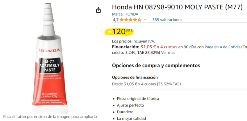

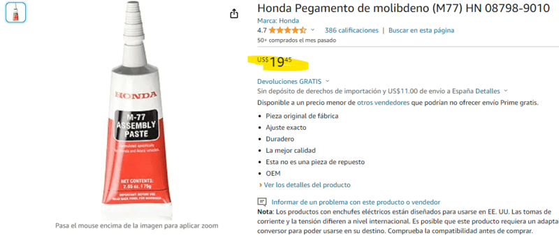

Tom.G said:
https://www.amazon.com/Honda-HN-08798-9010-MOLY-PASTE/dp/B0083BWUYW?tag=pfamazon01-20
(that was the first Google response of:
https://www.google.com/search?hl=en&q=moly+paste+60)
Cheers,
Tom
p.s. Good thing you did not use the unknown grease you found, this stuff is 60% MoS2!!
It seems the price is much more reasonable over there in the States. When I found the product here the price tag is significantly greater.

I tried very hard to source this product or an equivalent one such as Loctite Moly Paste locally but it's been impossible. I guess my best option is to buy it from the States and pay for the shipment. I don't know what makes it so expensive in Europe but I'd rather not pay +100€ for such a small bottle that it's really not worth that much. It's a x6 increment that I just can't understand.
I could finally end the maintenance on my bike. It took much longer than I expected but I learnt a lot in the process.
