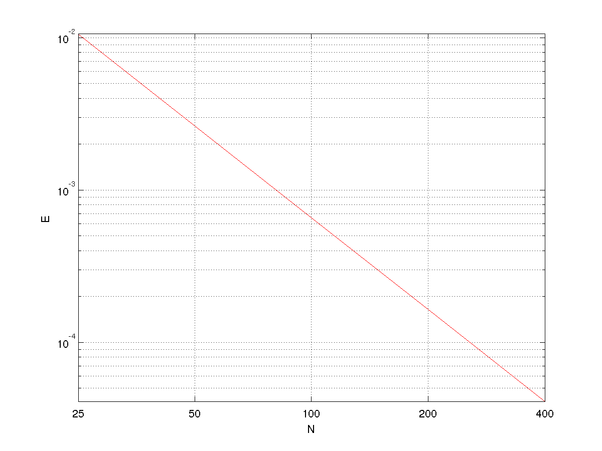

What does a loglog-graph represent?
For example if we have the following loglog-graph, which is the relation between $N$ and $E$ ?

Straight lines on a log-log plot correspond to power relationships of the form $y=a x^b$. The log-log plot can help you determine $a$ and $b$. See the link for info on how to do that.
So the loglog-graph of $E$ in respect to $N$ represents the graph of $\log (E)$ in respect to $\log (N)$, right?
Since the graphical representation of the function $\log{E (\log N)}$ is a straight line we conclude that the function is linear, so $\log E= a \log N+c \Rightarrow E=10^c N^a$.
Is it right so far?
Is it right so far?
Yep!
The following table shows N and E(N). How can we use it to find $c$ and $a$ ? (Thinking)
That depends on whether the data you have is exactly on the graph, or only approximately on the graph. If exact, then just pick two points, get yourself a system of two equations in two unknowns, and solve. If inexact, then first you should fit a straight line to the data (typically least-squares fit), then just transform that line the way you just have, and you're done.
I took the last two data for $N$ and $E(N)$ and so I got the equations:
$$\log ( 164 \cdot 10^{-6})=a \log{(2 \cdot 10^2)}+c \\ \log{(41 \cdot 10^{-6})}= a \log{(4 \cdot 10^2)}+c$$
from which I got $a=-2, c=\log (656)-2$.
But according to log'('0.000164')''='a'*'log'('200')''+'c, log'('0.000041')''='a'*'log'('400')''+'c - Wolfram|Alpha the result is wrong.
So do you think that I might have a mistake at my calculations? Because I can't find one.. (Sweating)
I'm confused. $\log(656)-2\approx 0.8169$, which is what W|A got.
So is my result right although at [m] Wolfram [/m] it is $a \approx -2 $ while I got $a=-2$ ? (Thinking)
If W|A says it's approximately 2, I wouldn't worry about it. At that point, you probably don't have that many significant figures anyway, so worrying about that level of accuracy is counter-productive.
