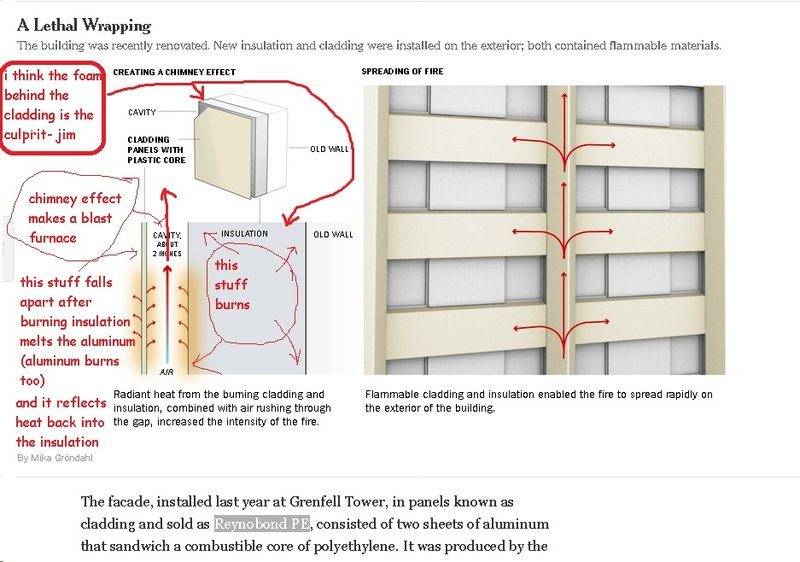

everybody has jumped on the paneling
seems to me we should question the foam behind it
from the NYT article(crude annotations mine)
https://www.nytimes.com/2017/06/24/world/europe/grenfell-tower-london-fire.html
If you build a chamber with one side heatproof, ie ceramic like a concrete wall
and the other side a heat reflector like the aluminum panel
then stuff it with fuel like that insulating foam against the concrete wall
and provide for forced draft of air, in this case convection over a lot of vertical height
you have built yourself a blast furnace or maybe a gigantic blowtorch.
If that foam adjacent the concrete wall is flammable,
i suspect those panels would have melted even if they were solid steel.
That they fell, probably aflame from their polyurethane sandwich, does not surprise me. Probably their support brackets failed from the heat.
But i bet it was spectacular . Are there reports of a tornado like roar?If anybody hears what was that foam , post a link to it?
Here's one to the panels. They meet ASTM E84.
https://www.arconic.com/aap/north_america/catalog/pdf/brochures/Reynobond_Brochure.pdf
How about the foam behind them ? Looks to me like that was the culprit.
It's a personal theory , just putting it out for consideration. We must await details.
If mentors want to delete as 'personal theory against guidelines' there's no hard feelings.

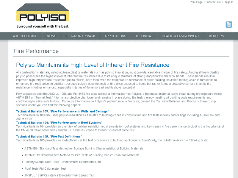

What's Polyisocyuranate?
http://www.polyiso.org/?page=FirePerformance
Looks like both components, insulation and panels, meet the ASTM E84 standard tests. Polysilo says it's 'resistant' up to 390F.
This is how codes and standards evolve as industry learns from its mistakes.
This one will teach standards organizations to test for "Chimney Effect" .

However, this applies solely to a unique construction based on two 12.5mm skins of plasterboard on a lightweight steel frame, with another 12.5mm of incombustible board, then the Celotex RS5000, and finally a further 12.5mm fibre cement facade panel.
In other word, the insulation has to be totally encapsulated in fireproof material.
Only if that construction is followed is the certification valid.
The manufacturer even warns architects about this by stating that “The fire performance and classification report issued only relates to the components detailed and constructed in Fig 4.
“Any changes to the components listed and construction method set out in figure 4 will need to be considered by the building designer”. That is another way of saying that if you depart from this specification – as the Grenfell Tower facade designer did – then the fire performance is invalid above 18m.
That leaves only the CE certificate. Celotex state that “CE marking confirms that our products fully comply with BS EN 13165 and that key performance characteristics have been verified through independent type testing”.
One would therefore assume that, since this is a product advertised for use in a fire-rated construction, the fire aspects will have been tested.
However, when you drill down into the certificate only the thermal performance and compressive strength have been verified.
The remaining 10 categories simply state “No Performance Determined”. This includes:
*Reaction to fire
*Release of Dangerous Substances
*Durability of reaction to fire against heat
* Durability of thermal resistance against heat.
Nowhere does it tell you that polyisocyanurate releases a lethal gas in a severe fire condition. Put simply, this certificate leaves so much risk with the designer that I would have no choice but to refuse to use the product.​
Likes 256bits and jim hardy
There's some detective work, mikezilla ..
Torts are going to fly.
Well you called it right, Jim, so you deserve most credit...
Architect spec'd insulation, probably to meet some UK environmental agengy edict.
Not sure there's much money to be had with a design firm, but if there was an actual manslaughter charge brought, it would probably fall on them. Can't see that happening given government had a role to play in this tragedy as well, but I'm not a lawyer.
I'm sure we'll be hearing about this firm soon, though.
Didn't anybody there remember the movie Towering Inferno?
