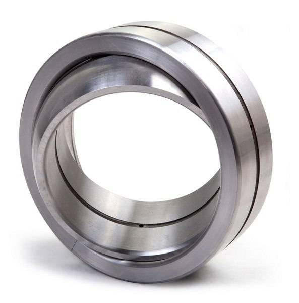

Maybe he means something like this, but with a handle spanning a diameter inside?
http://image.made-in-china.com/2f0j00HMKTaqEjaGzJ/Spherical-Plain-Bearings.jpg
Maybe. But if that was the case MichelKS could communicate it.
