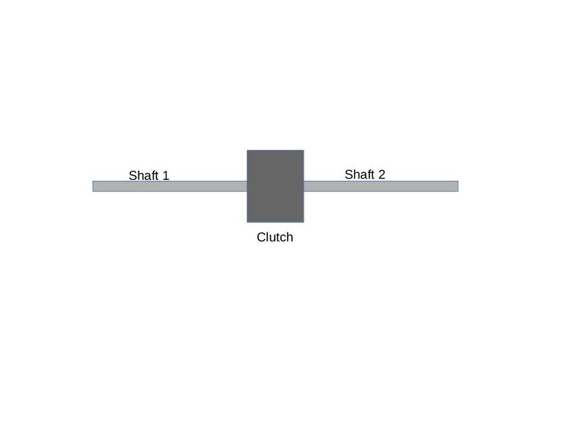

Hi,
I made an electronics project but I'm having some mechanical problems. Particularly, I'm having issues finding a good clutch for my problem.
What I'm trying to do:
A motor is connected to shaft 1, a human can manually rotate shaft 2.
I want that when the motor isn't doing anything, a human can easily rotate shaft 2. In case it matters, the human will rotate the shaft at most 3 rotations in either direction. When the motor rotates, both shaft 1 and shaft 2 need to move.

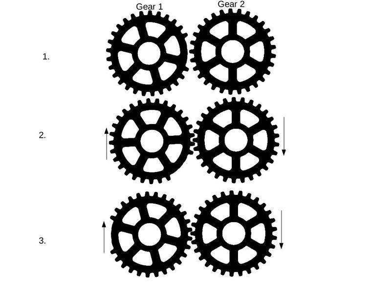

The solution I came up with:
1) gear 1 and gear2 are not engaged, hence gear 2 can rotate freely when the motor is not moving
2) The motor is turning, the gears interlock and so gear2 turns
3) continues until back in position 1
There are a few problems such as you need to be sure that when motor is at rest, there are no gears interlocking. However I might be able to find a solution for this. My biggest problem however is that if the motor's batteries die when it is engaged, there is no way that the user will be able to rotate shaft 2. Any solutions are always welcome =) Thanks!
The gears on your proposed solution will not last long. And the output shaft will not have constant velocity.
What is the power transferred? RPM? Does it operate in both directions? How often will it need to be rotated manually?
Have you looked at centrifugal clutches? The type found in go carts & mini bikes can be had for ~$20 new. Remote control car scale clutches can also be found cheaply.
Thanks for the reply! It will rotate at a maximum of 100 RPM (freerun) probably and a maximum of 2Nm (stall) torque. Yes it operates in both directions. I have briefly looked at centrifugal clutches but haven't found any that are small enough (must fit in 3cm^3). Also, when motor turns at let's say 1.5Nm, it might only do 10RPM or so. Not sure if this is fast enough for centrifugal clutch.
Considering that you would like to have a Human easily operate shaft two I complete isolation between shafts may be in order. Humans are very low power producers.
I would be interested to hear further a few items. 1) How much power can you afford to lose to parasitic losses such as in using a fluid coupling? 2) Will the shafts be coming to rest for engagement and disengagement? 3) Does the engagement need to be smooth are can you afford some clunkiness? 4) What modes of connection do you need to achieve? ie. either shaft only, both shafts together, either shaft locks out the other, etc.
